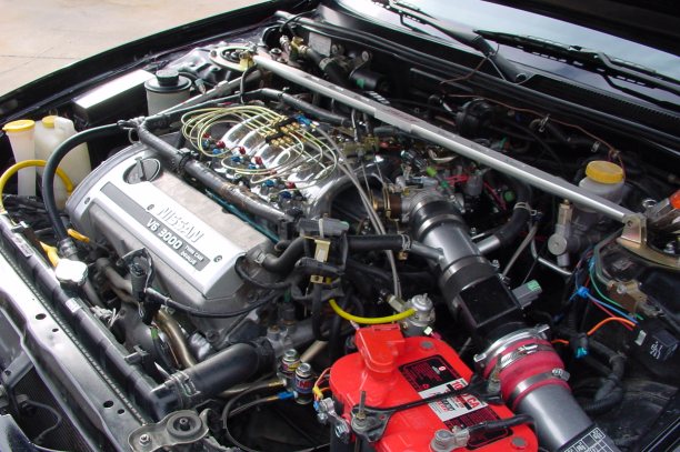

relax buddy, i've been there. circa 2002:
Old Jun 10, 2010 | 12:24 PM
streetzlegend's Avatar
Joined: Dec 2003
Posts: 4,097
Relax? Looks like you misinterpret my tone of text lol, cute picture.

Old Jun 10, 2010 | 01:11 PM
505max94se's Avatar
iTrader: (15)
Posts: 2,220
From: my garage
How much were you sprayin' with that nice dp setup?

125 shot i believe. good times. i should really put the max back together.
