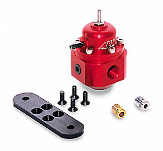

I'm trying to install my AEM universal fuel pressure regulator and it has an extra inlet port I need to seal up. Where could I find this plug? Is it something I can pick up at Home Depot?

This is all I got from AEM.
http://www.sx7r.com/images/aemfpr.jpg
There wasn't a big plug for the inlet port. I don't think I even got a plug for the gauge port, but that's no big deal. 1/8 NPT is easy to find.

tony, summit has it. i just put the AEM FPR in and got all the neccesary fittings/couplers/plugs from summit.
here is the plug you will need. its just a -6AN plug. Part# : EAR-581406.
http://store.summitracing.com/partde...t=EAR%2D581406
they come in a pack of two, i only used one. i have the extra here if you wanted i could mail it to you. let me know.
the -6AN to 9/16"-18 fitting adapter is for where your hose ends go. do you need the plug or the adapter? the adapter looks like this...
http://store.summitracing.com/partde...t=EAR%2D985006
