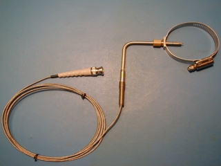

I installed a digital EGT gauge from Dynotune.org today in one of the y pipes that come down. I wasnt the one doing the install. I only did the wiring.
So when I wired everything up the EGT reads Extremely low 100-150 degrees in celcius. WTF. I ook everyhting apart myslef and installed it back together and still it reads 100-150. @WOT it read ~200+ and soonest i let go it jumped to 100 degrees. Whats going on?
Is it the probe? The location?
Can u specify what ur reading is when ur driving around and @ WOT.
Thank you.

I got it installed in a mufler shop where I get my custom exhaust done all the itme. I never had a problem with them. I think they f*cked it up because the Dynotune gauges are very fragile and they ruined it. They bended the brobe and when I took it out to look at it the tip was chipped off. So U think I should just get a new probe and go from there.
Also I used a clamp not a screw in bong. http://www.speedshop.org/store/ProdI..._bnc_large.jpg

Well the probe is the sending unit in effect. I think the probe is jacked up.

You meantioned that the probe has some pieces broken off it. If thats the case, then the probe is probably giving a wrong reading. That is what I meant by jacked up. Broken/deffective now.

If the you can get to the connections, make sure that the thermocouple wires are not reversed. If there is a red wire, that will be negative, oddly enough. Also check that the t-couple extension wire is not damaged. For example, if the wire was crushed you might have a short somewhere between the real t-couple and the indicator. This would form a new thermocouple outside the exhaust pipe which could explain the low temps that rapidly decay.

Well.. i sent back the probe and the company said it was damaged. Lets hope the new one will work so i can beat on my car.
