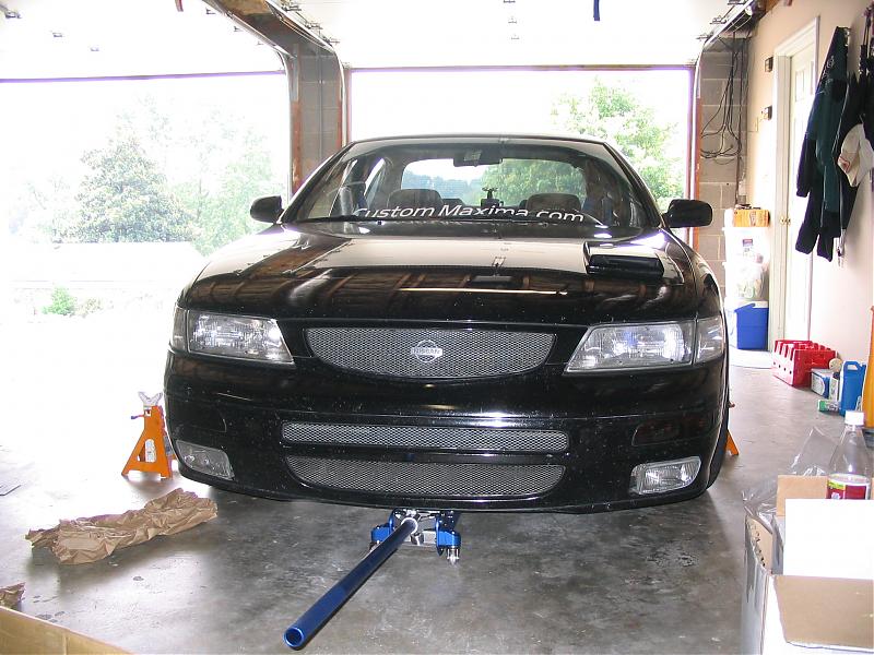

I cut in a 4 inch NACA duct into the hood to reduce the temp, works VERY WELL!!!!
You actually saw a temperature drop? Actually yesterday I put washers on the hood's bolts to lift it, at idle with a/c on, temps are lower than before. but while moving, temps are the same, I am thinkin maybe while driving there is pressure over the now-lifted hood and actually not letting the engine bay heat escape.
Ohh definitely saw a temp drop,.... I ran it hard and the temp was no higher than a normal run to the local grocery store.
Keeps the engine at a stable temperature in the summer. I calculated 4 inch duct would be optimal for cooling.

Damn that dosnt look bad at all. Im just curious, how is it that engine(coolant) temp can drop if your adding pressure to the engine bay, since that naca duct is meant for intake air into the engine bay rather than venting the high pressure.
Wait, i just noticed you have your filter located in the engine bay! which makes alot of sense of why you see a drop in temperature, probably because although there's still trapped air in there (one that comes thru the grill), ur also inducing colder air lowering the overall temp. btw what temp are you referring too? coolant temp, or intake air temp?

hey doc whats up with that website, it makes me curious no more on anything....
i also installed one of thoase naca ducet mine is made of carbon fiber and it rams straight into the intake box...
Both, it draws in cooler air as you stated it reduces both. I have to thermometer the coolant, Yet the thermostat keeps the temp at a regulated level. I will say the coolant temp is roughly 180-190. The lower part of the block on the opposing side of the NACA duct is lower than what it was when I didn t have the duct.
as for upgraded cooling i put a small after cooler after the turbo for the radiator fluid, like a tranny cooler but looped into the coling system..
can you clarify what you mean about the website????? Mine is also CF NACA duct.
yeah chris the scoop looks great, when gene told me about it I thought it was like this one:

http://secure.mckinneycorp.com/AMAZI...2D4410&eq=&Tp=
in case you guys were interested, here is where I ordered the NACA Duct.
www.mckinneycorp.com
i recommend the 2inch one if you're staying N/A

LOL. I personally love the duct method!!! got that BNR-34GTR NUR look to it
chexy IMO
Mckinneycorp takes a little time to deliver, but their product is of HIGH QUALITY!!!
The temperature of the coolant drops as well due to the ambient temperature dropping in the engine bay. Hot air that was stagnant before is now moved out due to acceleration, thus cooling the radiator faster as well as the coolant lines and engine components. Making temperature regulation much more stable.
