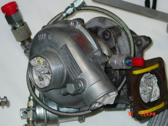

This is supposed to show up on my doorstep sometime this week:

what kind of turbo is that and what size?

Is that giant line in the back for water cooling?
It's made by IHI. It's just a little one but it ought to get me into the mid 9's.

That goin on a bike?!
Bingo.

You had me fooled into thinking that was going on the Maxima!
Are building all the piping for the turbo on your bike? Good luck, looks like fun.

Modified exhaust is included in the kit I bought, so no creative pipe dreaming needed on my part.
I don't think I'm going to stretch the swing arm. I know that will limit usable power, but I like having a bike that handles the twisties reasonably well.

How does fuel management work on the kit?

The bike is carbureted, and it is a blow-through kit, so the increased air flow results in more fuel sucked into the intake ports without the need of increasing fuel supply pressure (but more on that later). Steps have to be taken to make sure the carb float bowls see boost pressure so that the fuel will flow through the main jets in the presence of boost pressure, and the carbs have larger mains installed to provide adequate richness.
There is a fuel pump and fpr included that bumps the fuel pressure up to 3.5 psi under boost, but that is to ensure adequate fuel supply to the carb bowls so that they do not empty and not for increasing fuel flow into the intake.
It is definitely a cruder fuel management scheme than a fuel injected bike or car has, but it works pretty well without sacrificing driveability. I will be using my LM-1 wide band stuff for tuning, of course.

That's the intention. I did a trial fit a couple of weeks ago and worked out all the assembly details I wasn't sure about. The kit is made specifically for my bike, but it is used and one of the header pipes had apparently cracked. It was rewelded, but not very well, so right now I am fixing the repair job.
