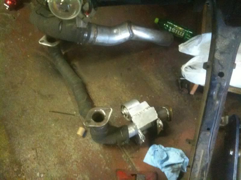

liking what was done with the motor mount here^^^
Apr 18, 2010 | 12:36 PM
  #56
Its a little different than what most people do. i did it so i could keep my a/c , its not close to the radiator, also i was able to retain ground clearance.

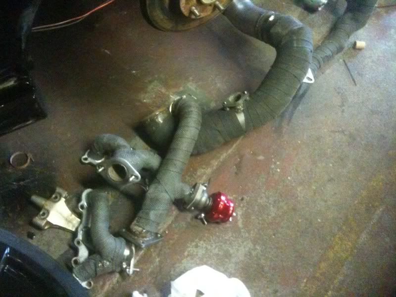

  #63
Nice work.
You may want to change the location of the bracket. Right now when the engine moves the bracket stops the turbo piping from moving. It will cause stress on it and break. You should make the bracket so it mounts to the engine. This way it will all move a one unit without any stress.
Ferhan
Don't worry. The bracket bolts to the motor side of the mount so it moves with the motor. The one one my car has 20,000 miles on it now and no issues, knock on wood.

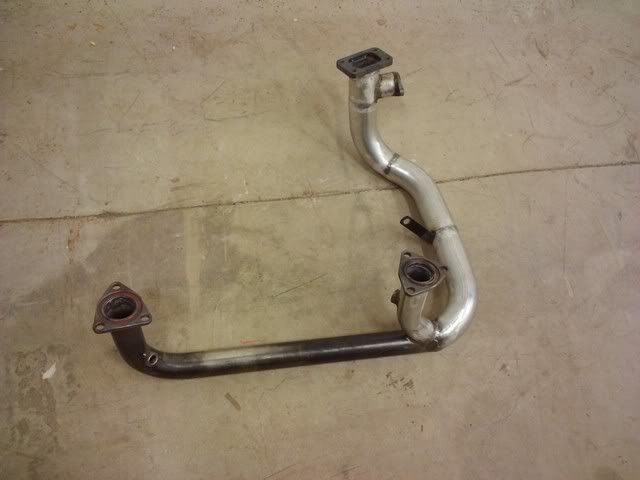

Nice setup. You said in your first post that you pressure-tested them. How do you do that?
I fabbed up a turbo setup for my VE a few years ago but sold the car and have had the "kit" in my attic for several years. I'm just now getting back around to messing with it and will be installing it in my blue VE in the spring.
Anyway, just curious how I would pressure test my y-pipe
Dec 1, 2010 | 04:34 AM
  #78
I used HVAC foil tape and a T3 flange plug that came with a turbo to plug the openings. then i poked a blowgun in and gave it some air while spraying all the joints with soapy water and looking for bubbles. Its the same method i use to find leaks in tires. Not really as necessary now that i have a tig welder though.

  #79
New motor mounts that allow the stock radiator to be retained are in the works. The 2.5" feed pipe will pass through the 3" round tube now instead of being routed in front of the mount. The rubber portion of the mount has also been welded solid to prevent motor movement and wheel hop.
