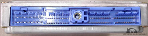

Old Jan 3, 2011 | 07:04 AM
  #68
maxam's Avatar
Posts: 293
Originally Posted by Kevlo911
You sure? I thought we had the same ECU connector but you guys just had OBD1 and 1 o2 in the front.
this is our ECU
and this is yours I think
Old Jan 3, 2011 | 09:49 AM

Wow, did not know that. All the cefiro ecu's I have seen had the USDM style ecu but with less emissions stuff.
I doubt you will find a plug-n-play harness for your ecu for the EU. But the EU is not that bad to wire in, it will take an hour or two to solder it in. It is a MUST imo to tune a boosted maxima safely.

actually your ecu is similar to VG30 and SR20 ecu's, you might find a p-n-p harness for those and mod it for your ecu

before around 5 monthes , I installed e manage blue . but it didn't work . my screen tells that there is a connection error . so I returned back my SAFC.
but I don't like cutting wires , shrink and soldring ....... so I have to find a plug n play harness that fits on my ECU .
or I may get one of JWT's or send my ECU to him , but i dont trust JWT .
I sent a messege to the site that you add . I asked them if there are bords for maxima , cefiro and I30 all A32s. I will white for their answere.
they have for Y33 (VQ30DET) I dont know if that one fits or not .

Yea you will likely have to send them a picture of your ECU, prob the inside. I am 90% sure you can use those Nistune boards(I think we can too but I dont have 400 to experiment)
I for got to send them the pic but I got there answer
Sorry
it doesnt work on those vehicles. I have an A32 maxima ECU here but1997 model to get working on the Type 4 OBD-II board. Other later models areprobably FLASH based ECUs.
Regards.
Matt Brown
Regards.
Matt Brown
Managing Director
Nistune Developments
I didn't understand any thing
Yea he is talking about the USA maxima it seems like. Show him the picture of your ecu connector and see if he says anything different(like if he wants to see the inside of it)
I sent the picture . I will be whiting for thier answer.
