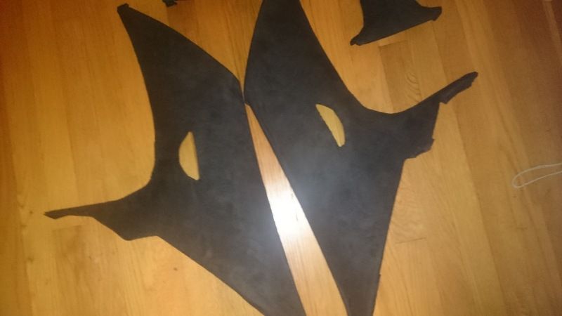

The only other 2 i have for now, made my own suede shift boot and da wrapping:
