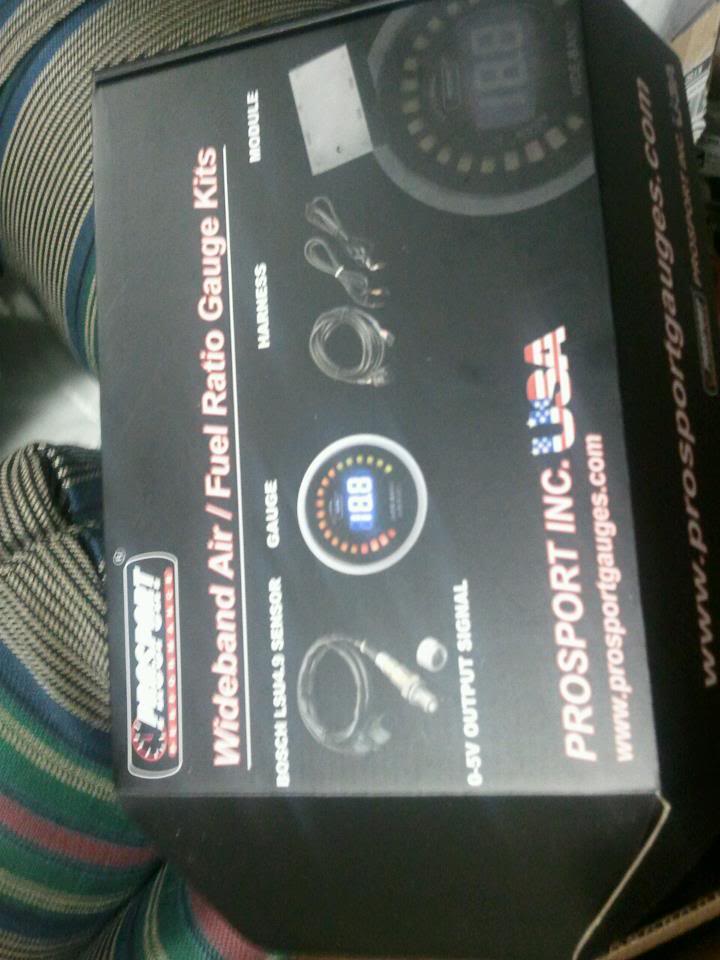

Gauges & Gauge POD

down pipingName:  downpiping.jpg
