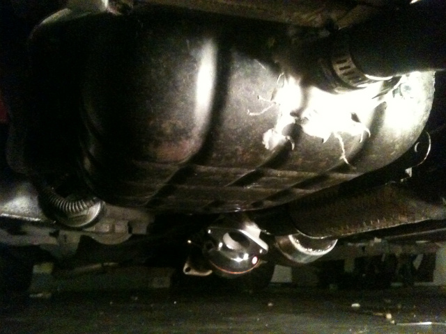

VQtHuRtY's Avatar
Joined: Aug 2009
Posts: 659
From: San Antonio
I have it ran to the lower oil pan, no issues. So, Im pretty confident to say, it may be your turbo, as much as I know you wish to hear different. Here's a pic of mine...
thanks man, that´s what i need to hear and see, that´s the same oil return i have
