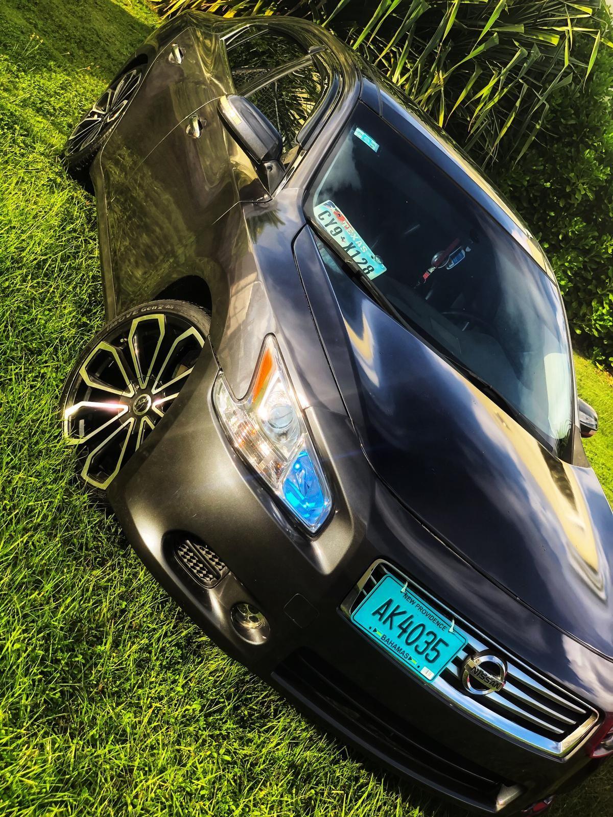

Old Dec 14, 2019 | 02:57 PM
Clarke242's Avatar
Joined: Aug 2019
2012 Nissan Maxima
Originally Posted by limsandy
Thanks for the heads up. I have searched around and found that there are only a handful of members who have 20". Sure there are a lot of people running 18" and 19", but 20" is quite rare. The biggest concern here is rubbing, I dont really care about keeping the overall diamater the same. Of course, I want to get it as close as the stock ones. The offset is 40 mm, as stated at the top of this thread, first post. Actually, I wasn't gonna slap you. I was kidding with you, and therefore the big smiley face next to the icon.
~limsandy
I can say the 20” wheels will fit the car and no they will not rub, BUT THERE IS A SLIGHT PROBLEM I’m facing... my car seems a bit low. The car is on 18” springs I’m wondering should I change them to 19” springs to accommodate the 20” rims..
