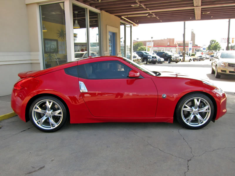

Flanker84 - The wheels are the rear, stock 370Z rims in the attached photo. The wheels are 18 x 9.0 in. and the tires are P245/45R.
If I have to make a lot of additional mods, I will purchase rims that are similar looking, but don't require other changes. I just like these wheels better than anything else I have come across.
