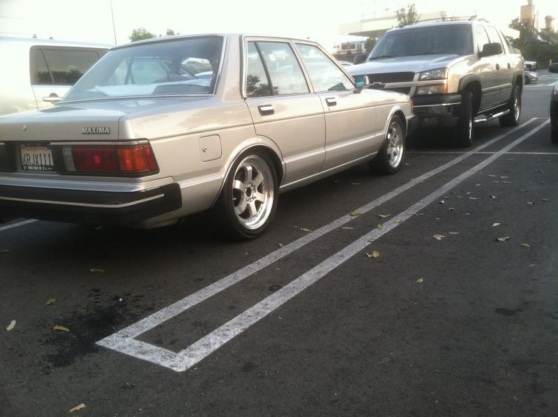

Captain,
I recently installed 17x7" ET 38 wheels on my '84 Maxima, using 205/50-17 Yokohama AD08Rs, and I have 3mm of space between the sidewall and strut. I can get away with this without rubbing on the strut (I get some rubbing on the fender liners with maximum effort cornering) because this arrangement yields an absolutely flat sidewall, and the AD08Rs have steel sidewall stiffeners.
I imagine if you use 17x7" or 17x7.5 ET30 wheels with 215/45 tires, things should fit if you roll the fenders. Of course, to my knowledge there are no off-the-shelf wheels with 30mm offset available, so unless you get lucky on some used wheels or use spacers, you will have to pay $1300-2000 or more for custom drilled and machined offset wheels. Spacers are a problem, because the stock wheel studs are only 32mm long on the front and 40mm on the rear.
See photo for results. That photo was taken before I replaced the tired rear springs with Moog CC233's, which popped the rear end up a couple of inches.

^^ I like Your 84 Maxima (810) that looks nice^^

Yea, me too. It's clean.

Looks good, If I honestly think I can get a 215 in the back, and then just do 205 in front. Largest wheel I am gonna do is "15 maybe 16.
How bout ET25?

Thanks.
Captain,
I replied to your message on the Maxima forum. I think 205s will work with ET25 if you roll the fenders. They don't hit the fender lip with ET30, but then I shaved off the protrusion around the mounting hole for the fender trim. Go for 205 55/16s. Lots of good rubber available in that size. Staggered works well on properly-tuned RWD Maximas. I wear the tires pretty evenly front to rear on my '83, and don't bother to rotate them.

I never saw this thread originally but looking at the old pictures now it's kind of funny, because my brother has a '79 CVCC in that exact same bronze color too. And his also came from California and has that exact old style blue California license plate. Pretty funny for a split second I thought it was his car.
