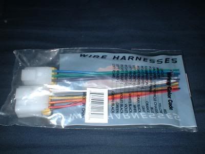

ok... heres the story, i got new sony rear 6x9s and a new head unit. i am planning on just bypassing the amps on the fronts for now. i need to know if i have all the right stuff and if not what i need and blah blah blah.
Heres some pics of what i already have. (minues the speakers)

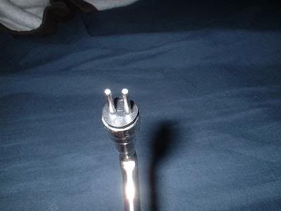

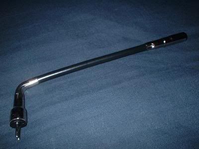

whats that funny metal thing in the last 3 pictures?? you need some speaker wire. to bypas the front amps is easy, but get high pass filters for the front channels. the bose speaker are 2 ohm and they will hurt your head unit. you also have to take apert the entire pod that the front speakers are in to by pass

lol the funny metal thing is the other end of the antenna adapter. is this the right one?

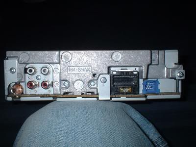

yeah theres an adapter, for them, mine had the same plugs i think, but it was a cable and not all sophisticated. Does your deck have a sub output or is it just the 2 preamps.

I think that isn't the right adaptor. The 2 prongs should be male. I got my adaptor at vircuitcity for $12. I'd also advise getting some new 4" speakers. I just put in a Pioneer HU and didnt change the front speakers and the radio would keep cutting out at low volumes. I bought a couple 4" Pioneers from Walmart for $40 and the problem stopped!

those two prongs are male. i had an adaptor for my stereo, but it was a cable as well. im pretty sure the adaptor works like so. you have a antenna cable already coming in with two prongs, so you want a female two prong to a one prong male. that is if your head unit is a one prong, cant tell its hard to see. where did you get that adaptor. I got mine from crutchfield because of a really nice discount i worked out and it included the antenna adaptor and wiring harness FREE.
http://www.crutchfield.com/S-Rd2ylan...sp?i=12040NI10
this is the one you want.
and dont run the stock speakers in front, thats a bad idea for your new head unit. blose and regular equipment run on diff ohms making it bad to run both. im sure someone will chime in and say they do it and havnt had a problem, but its not recommended at all.

I meant female, it was late when I posted that The one from the car is male, so the adaptor should be female. TripleG thats the one I have, also I'll chime in and say I did it and it was the worst thing I couldve done to my new HU!
