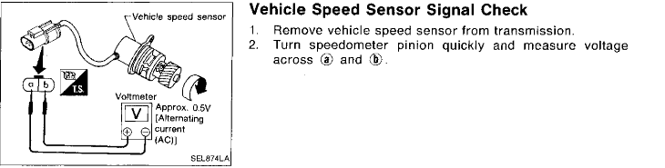

My speedometer pegs to the max most of the time now in my 90 GXE which in turn causes my odometer not to work. I heard there was a way to test the vehicle speed sensor to see if that was the problem, but I don't know how. It is located behind the oil filter. My Haynes manual is no help. Any help out there? Thanks.

I found this in a couple of other messages on this site.

Just to let anyone reading the thread know. Its usually not the speed sensor. It's usually a bad speedometer cluster (and good luck finding one now).
