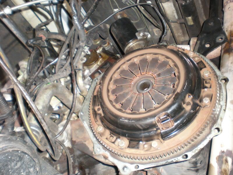

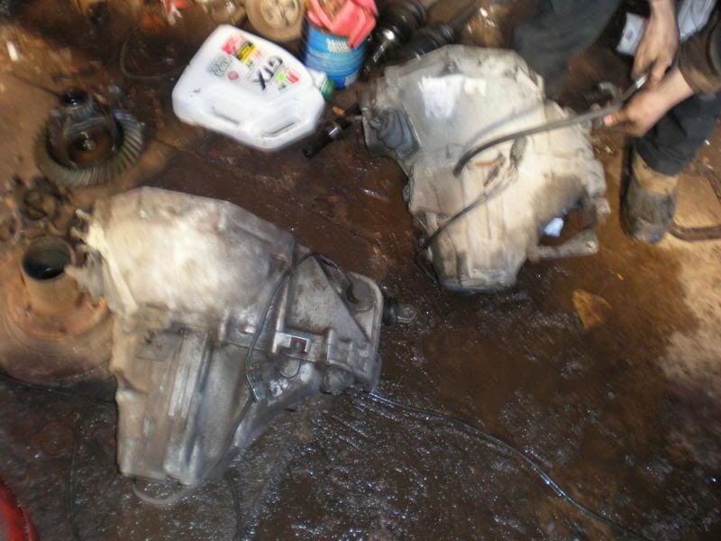

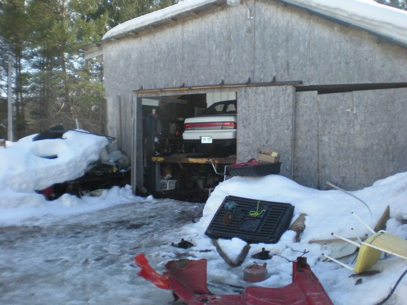

Picture time!
The shop we worked in:
Pic showing there isn't / never was a pilot bushing:
Pic illustrating how camber CAN be adjusted w/o installing camber plates:
