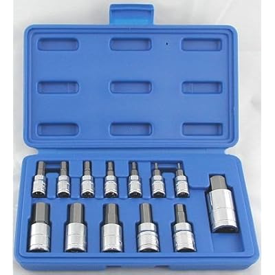

Im sure you have them, but I reccommend the allen wrenches that you can put on a wrench. Makes it easier unbolting the IM. Other than that, its pretty straight forward for tools needed.

If your not sure what im talking about because im not sure the exact name....

thanks man. Can you use these with a breaker bar for this application or do you need an airgun and air compressor set up? On the egr bypass set up, could you possibly use stainless steel braided hose lines or does it need to be made out of solid metal tubing? I haven't actually gone to look at it so this might be a stupid question. Im only asking this because it seems that everyone else has the same question when it comes to the emmissions inspection, and having to reconnect everything for the emmisions test

Looks like they'll work with any kind of 3/8, and 1/2 ratchet/ breaker bar/ impact wrench. Though when working with the intake manifold, I would suggest just using a quality ratchet set.

sweet bro! Thanks for the help man. I was wanting to get an idea of what I would be looking at as far as work involved, and tools needed before I got in over my head
