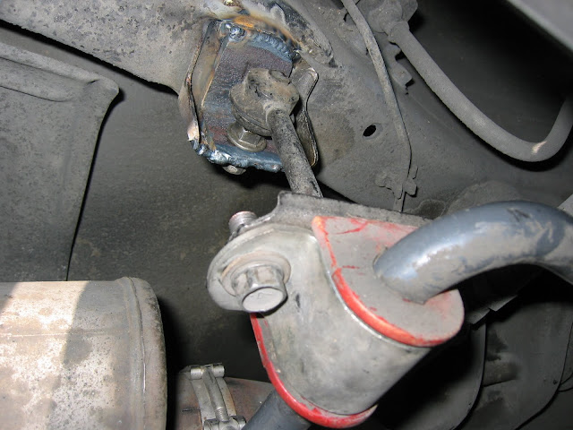

My stock rear swaybar mounting bracket recently broke, after a few years of driving around on upgraded (Suspention Techniques) front and rear swaybars (with stock "soft" GXE springs). The sheetmetal bracket broke in the form of a "washer" shape, which I TIG welded back into place.
But rather than just weld it up as good as stock, I took inspiration from Matt's
"Blemco" rear link design, and welded a chunk of 1.5" angle iron as reinforcement. I left the stock bracket in tact and welded the angle iron right next to it to reinforce it.
I'll have to get a little paint on there as well to protect the bare welded metal. It is possible that interference between the rear swaybar and my custom exhaust/muffler caused the failure, so I will need to adjust the exhaust system, and also maybe throw a couple needed motor mounts to reduce exhaust system movement as well in the near future.
My stock rear sway links and their spherical joints are however still going strong... no signs of play. Hope this info might prove useful to someone!

Sorry to bring up an old thread, but this is what I need to do. Gotta love that search button.

For now just going to tack a couple of 1/2" washers on to existing tabs until I can get blehmco.
