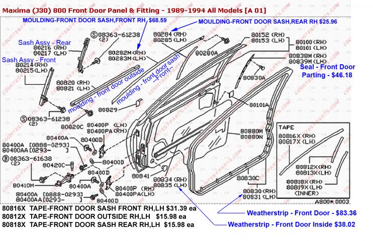

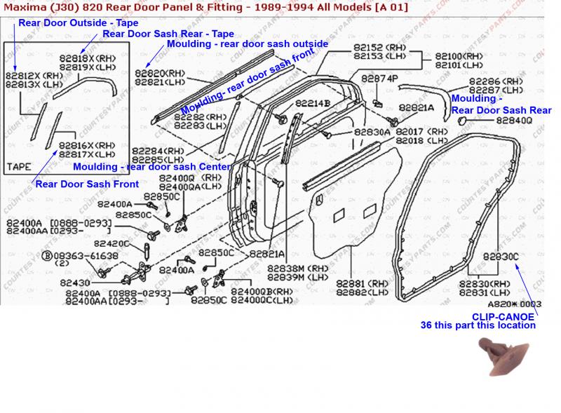

Total, I'm working on 3 chrome trim pieces framing each of the 4 side windows. The 4th window side, that composing the door pillars, has black taped chrome strips also, but are still on the car as we haven't figured out how to remove them; the body shop plans to do those on the car. But now I wonder If that's going to work.

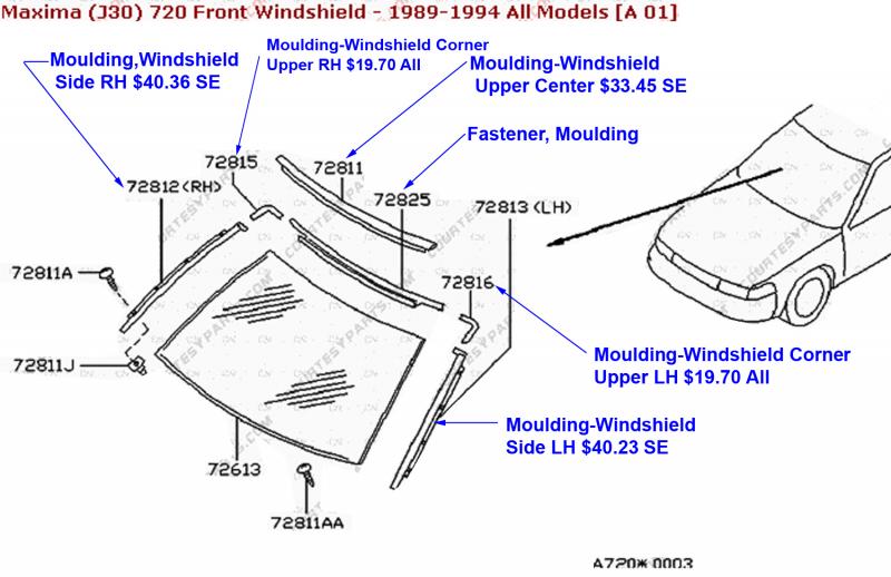

Front Windshield and Rear Window also have this black taped chrome trim also. I bought the 1 piece moulding (trim) for the Rear Window New from Courtesy Nissan, so that one's taken care of. I have two pieces also from the Front Windshield- (Left and Right) side trim pieces. A 3rd piece for the top of the Front Windshield is also still on the car.
In Total, I have 14 chrome trim pieces off the car that are 'blacked out' with this Nissan tape. With 3 (maybe 5) still on the car.
I've captured 3 of the Courtesy Nissan Diagrams that show these chrome trim pieces then marked them up in Photoshop (click on thumbnail to enlarge):
800 Front Door Panel & Fitting
Nissan tape over chrome on SE's - how to remove???-800-front-door-panel-fitting.jpg
820 Rear Door Panel & Fitting
Nissan tape over chrome on SE's - how to remove???-820-rear-door-panel-fitting.jpg
720 Front Windshield
Nissan tape over chrome on SE's - how to remove???-720-front-windshield-2.jpg
