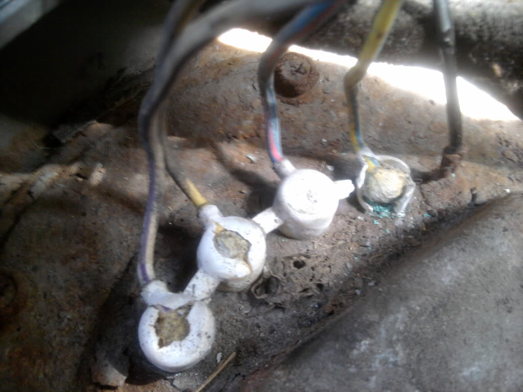

Removed the rear seat to check the fuel pump and found this
Does anyone know what exactly these wires are? I cant find it anywhere. Are these the fuel sending unit or fuel pump? Or am I talking about the same thing? Idk how these went bad when the car has just been sitting this whole time

So does anyone know what these 4 wires are exactly? I'm confused and frustrated at this point the car ran with no problems before all of this

yes; the wires are for the fuel gauge sender and fuel pump.
I haven't seen many die like that, so a trip to the junkyard will be the fastest fix.

Yea that's what I meant, but like I said I put new gas in it the day before. I know it runs fine because when I put a new fuse in it starts right up and runs perfect, but then the fuse blows after like 10 seconds. So now I'm trying to figure out what these wires are at this point.
Wondering if I can just run new wires maybe? Because a few of them are exposed like shown in the picture

Ok thanks man. Does it matter which maxima I get it out of? I highly doubt ill find a ve in any of the junkyards near me. Mostly just GXEs

afaik, all 3rd gens are the same right there.
I'm gonna be lazy and not whip out my fsm, so I can't recall if the sending unit is hard-wired into those terminals. If it is, get a non-digital-cluster sending unit.
fuel pump unplugs/unscrews, so you wouldn't necessarily need that (but another pump can't hurt right now)

I've replaced mine just a couple of months ago. 1 wire for the ground, 1 for the power, 1 for the gauge, and I'm not sure about the other one. I replaced mine with airtex (I know, it's a cheapo but it works fine so far. I just don't let the fuel be lower than a quarter tank). The wires are soldered so just desolder the 2 wires that goes to the pump (a pos and a neg). Put the rubber spacer and the sleeve, done.

Well I went to the junkyard today and pulled a fuel pump out of i believe a 90 gxe. Anyways I installed the pump and it solved my issue. Idk how bc the connections actually looked just as bad as the original pump, but im not complaining as long as it runs lol
