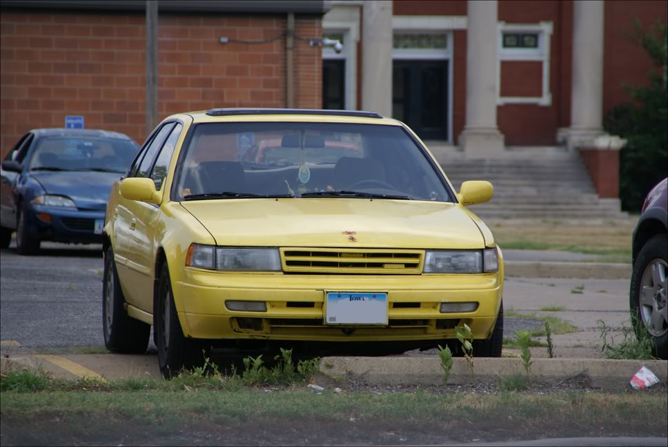

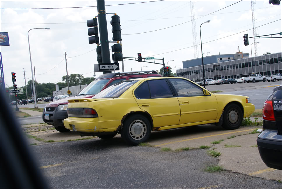

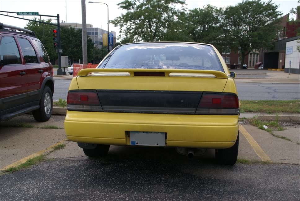

Well a couple blocks from where my car was parked in a parking lot across from the copshop sat the fabled yellow car. And I happened to have a camera with me. A hell of a camera at that: Had to post this for you guys

^Poor car :sad: love the color, though. works well, actually.

Yeah, that rust is BAD. I am not used to seeing that kind of damage.
That yellow isn't half bad looking. Not something I would buy, but I don't hate it.

That is pretty bad rust on the quarter panel. However theres a burgandy 92+ gxe Ive seen around town that has that kind of rust throughout the rocker panels and front fenders as well. If you saw it you would be like
Looks like it could get flat tires just from metal flaking off of it
