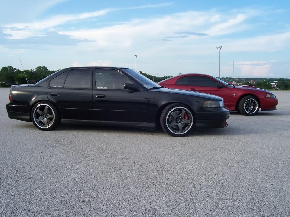

For reference - here's my black VE on Intrax all around. I actually love the ride height of Intrax all around. BUT my Greddy catback scraped on all driveways backing out, and it was very hard to drive with passengers in the back and not be scraping everything constantly.
Now thats sweet.Originally Posted by James92SE
