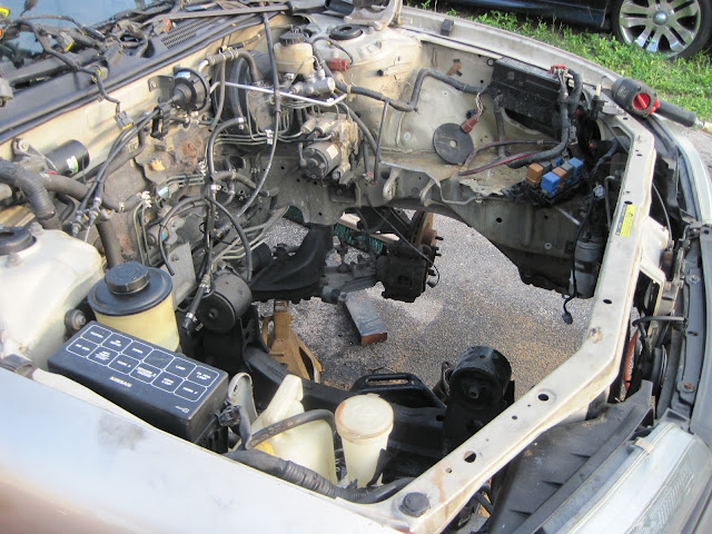

I was thinking about can spraying the engine bay black, has anyone done this before , and is there a certain spray can I should buy. I'm doing it the cheap way. Soon I plan to paint the car white or black. Thanks

Take advantage now that your engine is out. I'm not trying to make it perfect, just enough where you can't see the ugly color beige.
