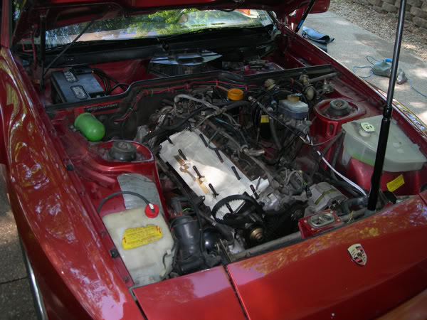

Sounds like the ones on my 944, they are a pain.

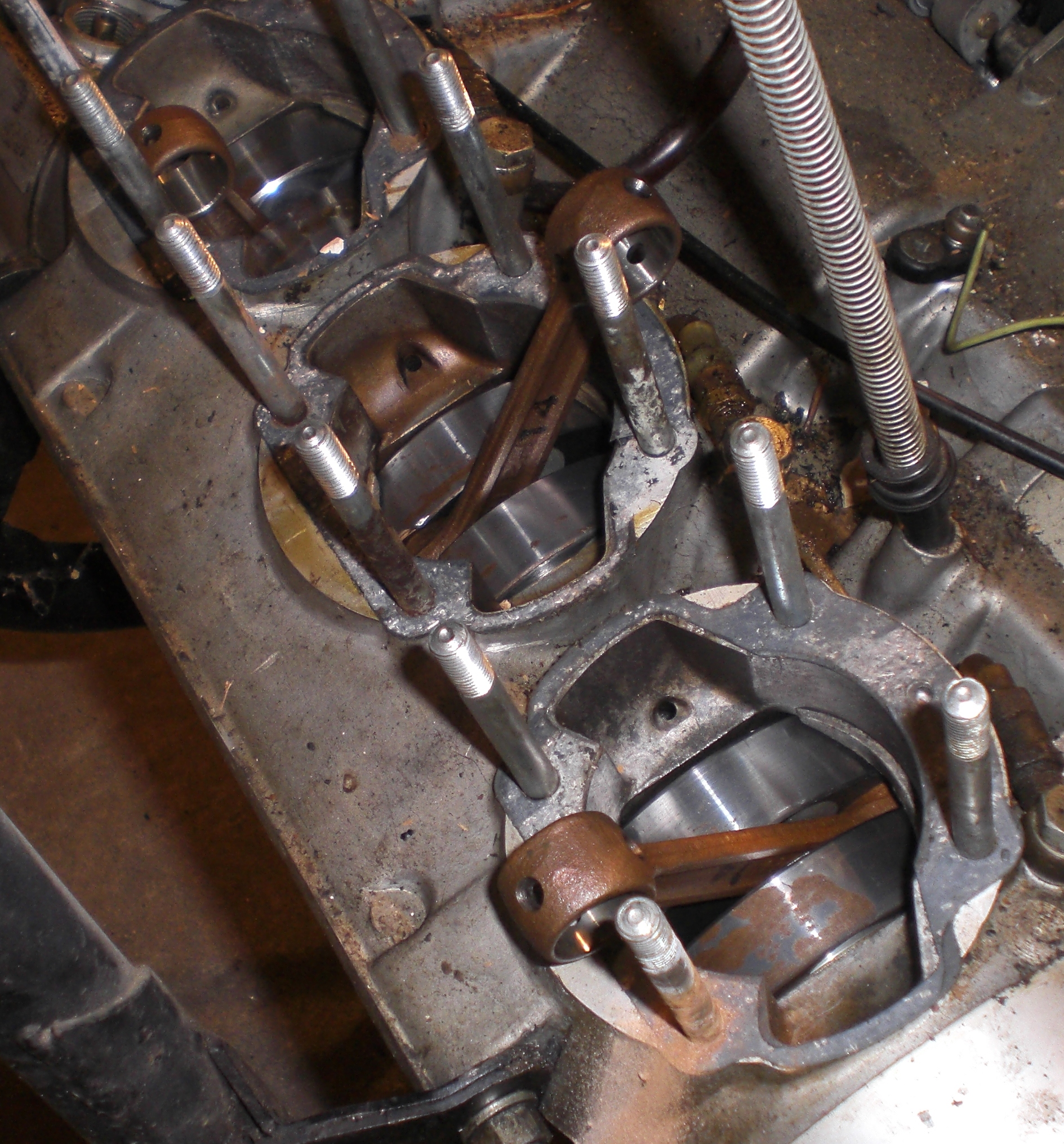

Had to tear the upper end down a few years back -

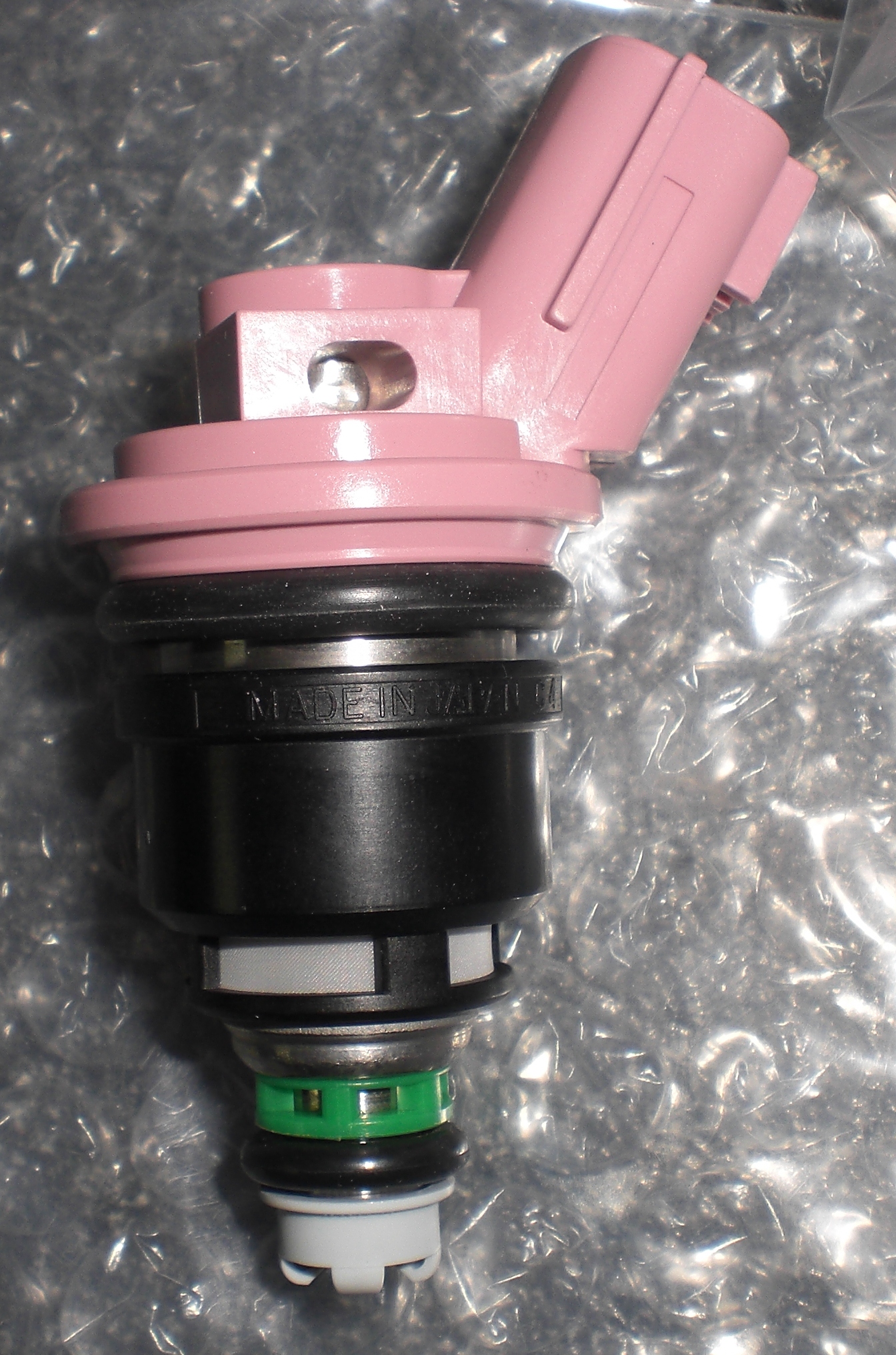

My Nissan ordered parts arrived - I may of ordered too many pieces, better to have something than not IMO.
  • 16635-53J0A Injector Insulator x 6
  • 16618-53J00 O-Ring x 10 (5/pkg)
  • 16618-10V05 O-Ring x 6
  • 16635-10V10 Injector Insulator x6
  • 16175-89E10 Gasket Throttle Body x1
  • 16175-89E00 Gasket Throttle Body x1
  • 14032-89E01 Manifold Gasket x1
  • 14033-0P001 Manifold Gasket x1
I hope to sell anything I don't use, as well as the old injectors (a couple are newer). I'll ohm test them prior to listing them.
Injectors should be here Monday - I'm trying to get this done and out of the way by then:

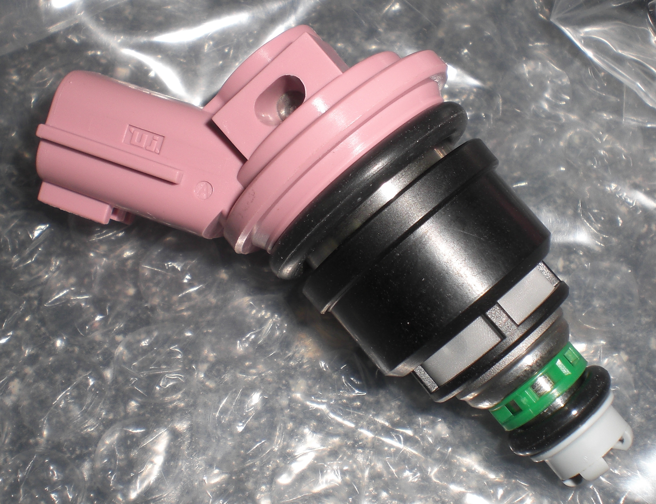

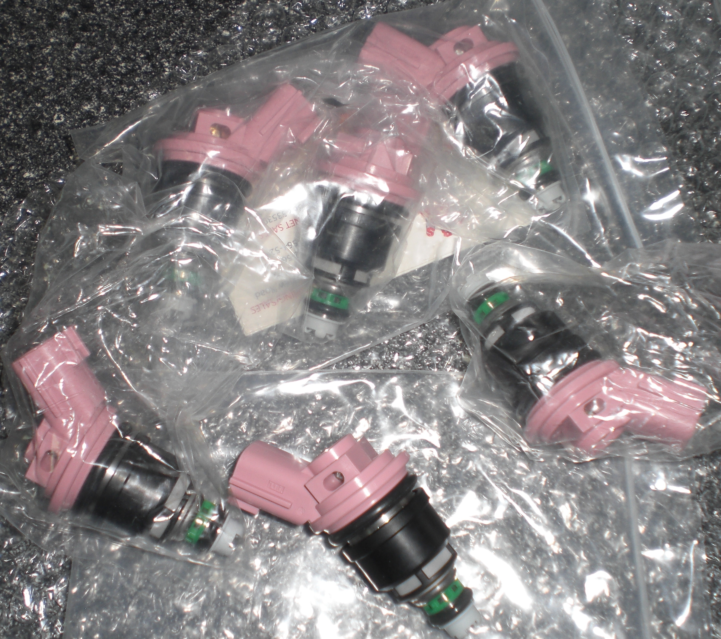

Injectors arrived -

"Brand new not rebuilt" and from an OEM Manufacturer in Japan
Web surfing:
Unisa JECS make them and they can be branded as Nismo, Apexi, HKS or Tomei
Wiki
JECS Corporation is an automotive components company headquartered in Isesaki, Gunma, Japan and a wholly owned subsidiary of Hitachi. Its principal products are electronic control units, software, semiconductors, mechatronics, resin molding, inspection technology and material analysis.
JECS was formed in June 1973. It was a joint venture between Robert Bosch GmbH, Nissan Motor Co. and Diesel Kiki Co., Ltd.. It enabled Nissan to use Bosch's engine control technology, and gave Bosch access to the Japanese market. JECS later expanded to manufacture many other automotive parts besides EFI systems.
All 6 of them, delivered, $359.70 or $59.95 each

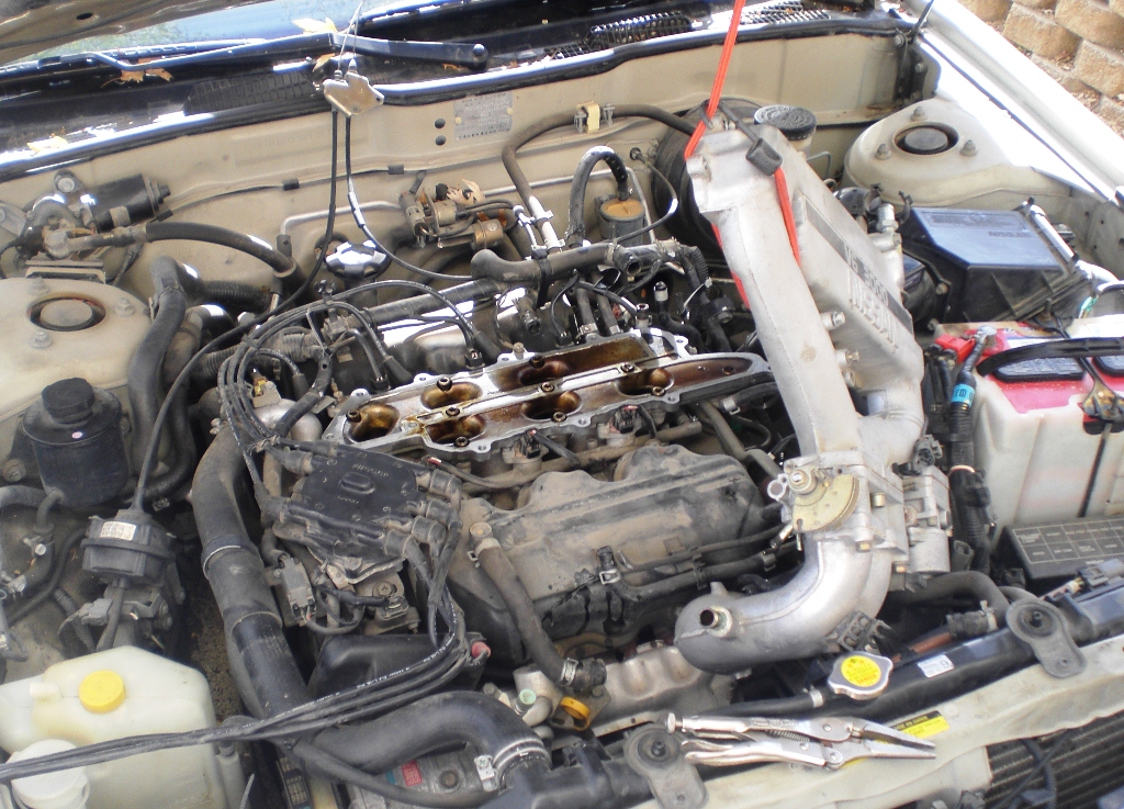

Well, it took me a while, but I finally got started at 12:30
Had to run to Walmart for Throttle Body Cleaner, bought three cans, needed less than two.

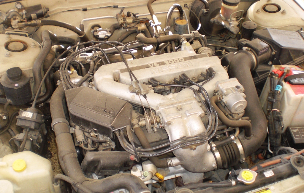

Here is it before I started -
I went and found my satin tip counter brush and swept everything off. It make quick work of a quick clean, or dusting.
Next I started the car and then pulled the fuel pump fuse - top right of the fuse box. Took a few seconds, car died. Tried to start it, nope, we're good.
Disconnected the negative terminal of the battery.
Removed the front three spark plug wires and throttle control cables.
Started at the left rear and worked my way clockwise, studying the various hoses and connectors and grounds and such, not bad.
Started taking everything apart, really, fairly simple.
The throttle body, left it and as much as I could attached to the upper intake.

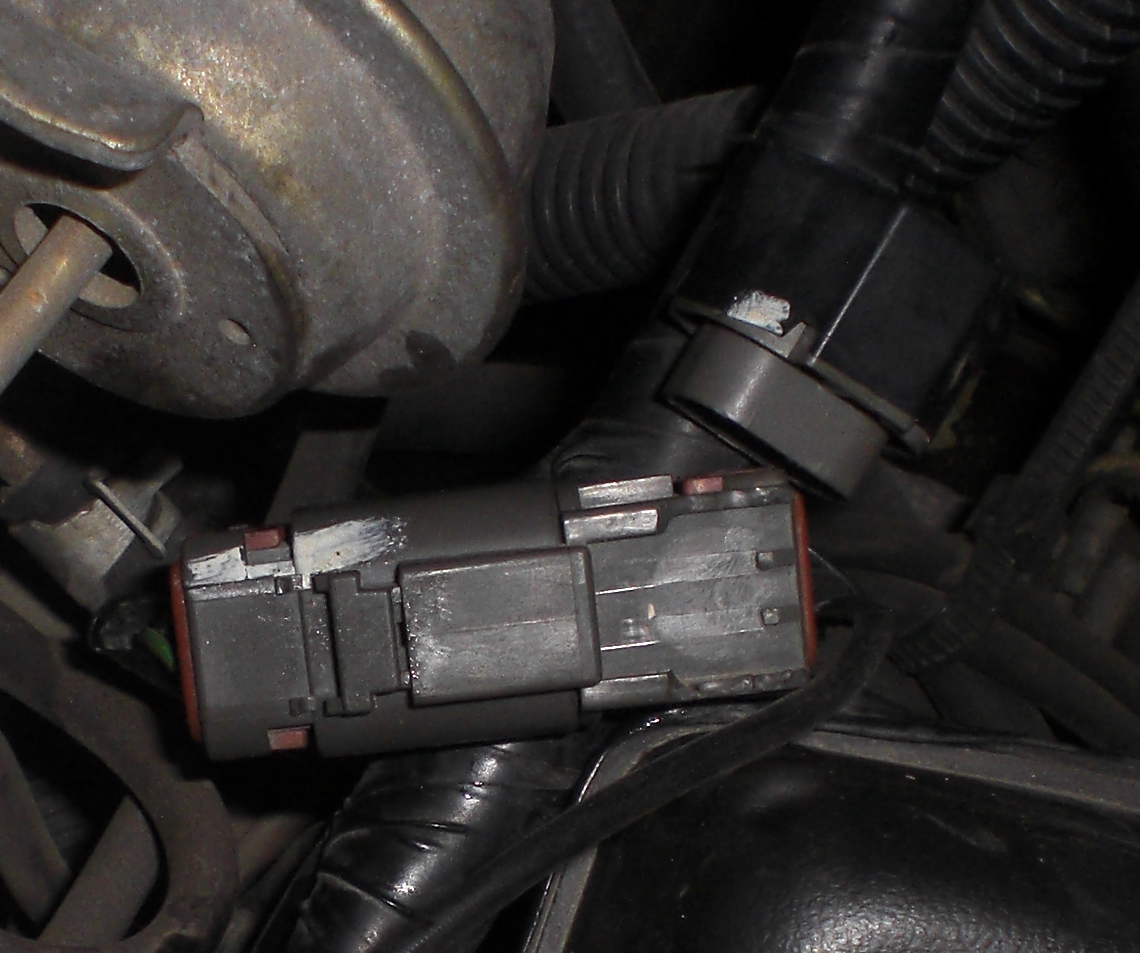

I had one left over connector, I'm not sure I hooked it up right, but the car runs great. Here is a picture -

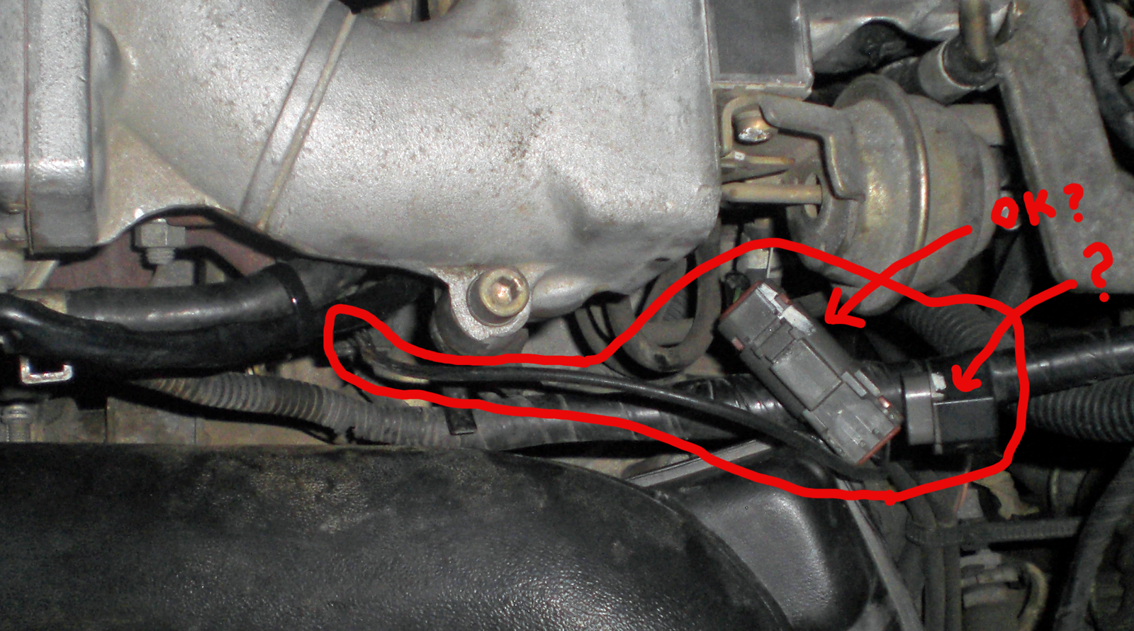

Look OK? What is the connector end that is attached to the other wire? Does anything go to it? Oiy.....

Yeah that connection doesn't go to anything, mine has that to. Also figured out my idle and cold start problem. It was the iacv was dirty.
