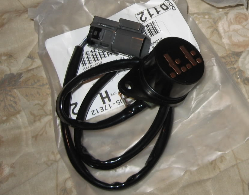

Might want to test it then.
On the car side of the harness:
The red/black wire should have ~3.1Ω to ground at all times assuming both bulbs are intact (2x 1156 bulbs in parallel.... 27W per bulb... 27W/12.8v = 2.1A.... 12.8V/2.1A = 6.09Ω... 2 of those in parallel = 3.045Ω plus the resistance of wiring/connectors).
The green wire directly across from the red/black wire should have 12v to ground with they key turned ON.
Then test the switch:
The pins that connect to those 2 wires on the switch side (wire colors don't match the car harness iirc), should show connectivity when in reverse (as close to 0Ω as you can get), and open circuit in any other gear.
What happened on mine is that the sliding contact for the switch slowly bent over the course of time, so it no longer connected the circuit regardless of the gear position.
new switch seen bottom-left

You can see that white plastic thing attaches into this metal block on the shift selector inside the tranny... and moves back and forth like that in neutral. If you put it in gear, it will turn one way or the other (hence why the springy contact thing has a pivot on it, so the contact can slide straight while the plastic part turns)
