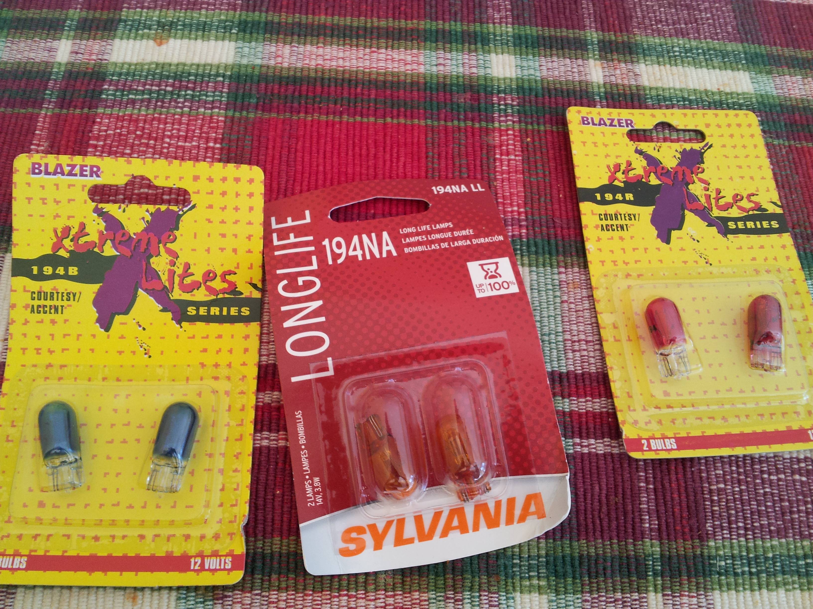

Sorry this took so long, but i want to replace my gauge cluster lights. I read on a youtube video, of someone who had a 3rd gen se, that he used 194 bulbs. I want three different lights, one for

You didn't finish your post, but I take it that you want different color output on each gauge? There's a problem which a cluster uses 4 or 5 bulbs (depends on year) and they're not positioned as you would expect to make full use of those bulbs. I will post a pic about it.
Also, I'd return the blue and red bulbs. I got the blue ones before and ended up taking them out because the color output didn't come out as I expected. I suggest getting LEDs as they will give you a MUCH better color output.

I have to agree with your opinion on those colored bulbs... i tried the blue ones for the city lights on my '99 Prelude with poor results.

Yes i was intending three different colors, for the three different gauges.
But, for the LEDS, what specefic LED bulbs work?

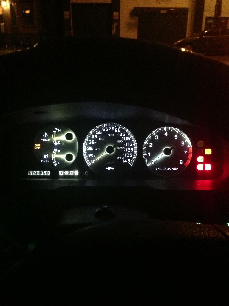

Picture of my cluster with led

Wow that is nice work! How long did that take you?

it didn't took long to do,,,, it was very simple

do you by any chance have the specifications of the lights you used? And do i have to remove the whole steering column, like i dont have the instructions to do that haha. Maybe the haynes manual will help

that's the one I used, you will have to purchase 4 of them and no u don't have to drop the steering wheel
if you want I can make a video to show you how to remove and install

What color is this? They appear be a warm clear color LED

The color is cool white
