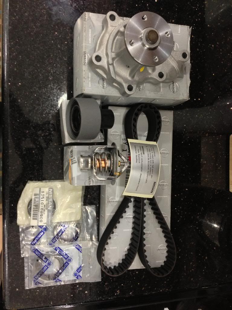

Gotta do it right with all OEM parts... The whole works...

I'll take the remains of the interval sticker (instructions), or the whole thing if you don't use the sticker.
Good job not settling for aftermarket junk.

Sure if u want the remains....when it come to go a timing belt job... I like to do it the right way. I seen a lot of people went cheap and 2 months later BANG timing belt snap

two more things to get...
the spring for the tensioner and the stud the spring pushes on.

Yes I actually purchase the spring and the stud but it was on backorder... And will be picking them up today...

Yeah definitely replace that old stud and spring. I didn't, against my better judgement since I was in a rush and didn't want to wait for more parts.
Now I get to hope neither stud nor spring breaks LOL... shoulda just replaced them damnit! Peace of mind..

Additional things to replace while you have the front of the motor torn down are the cam seals. They get hard and old with age and leak oil. The rear seal is hard to get to while in the car but not impossible. Just be very careful not to scratch or gouge the cam surface while pulling out the old seal.
