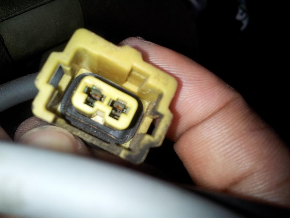

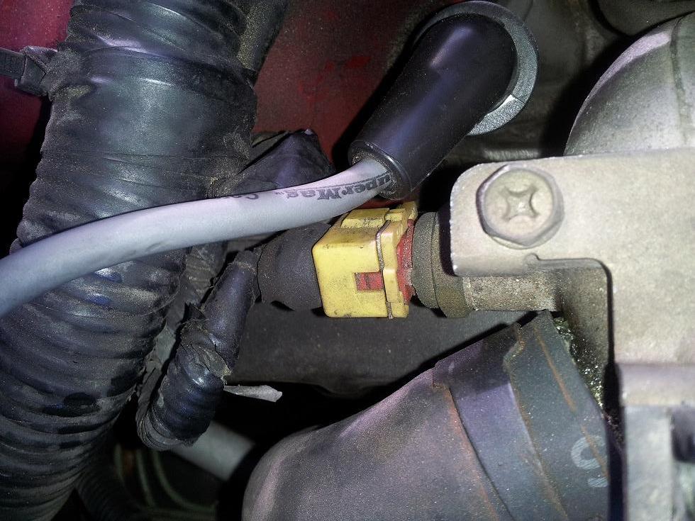

I assumed this was it.
The black protective tube to this was broken but the wires didn't look damaged. Covered them in electrical tape.

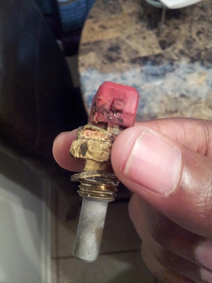

This is the old one once i got it out. Was kind of a pain to get out, but once i got the right sized wrench it was a breeze.
Wow that sensor is looking pretty rough lol. That sensor also plays a big role in the operation of your fans kicking on and off. If you do find you have an issue starting try making sure the shifter is all the way in park if it's an auto. The shifter bushing can tend to wear causing a little bit of play in the shifter. Starting in neutral should work aswell if you find you have an issue again give that a try.
