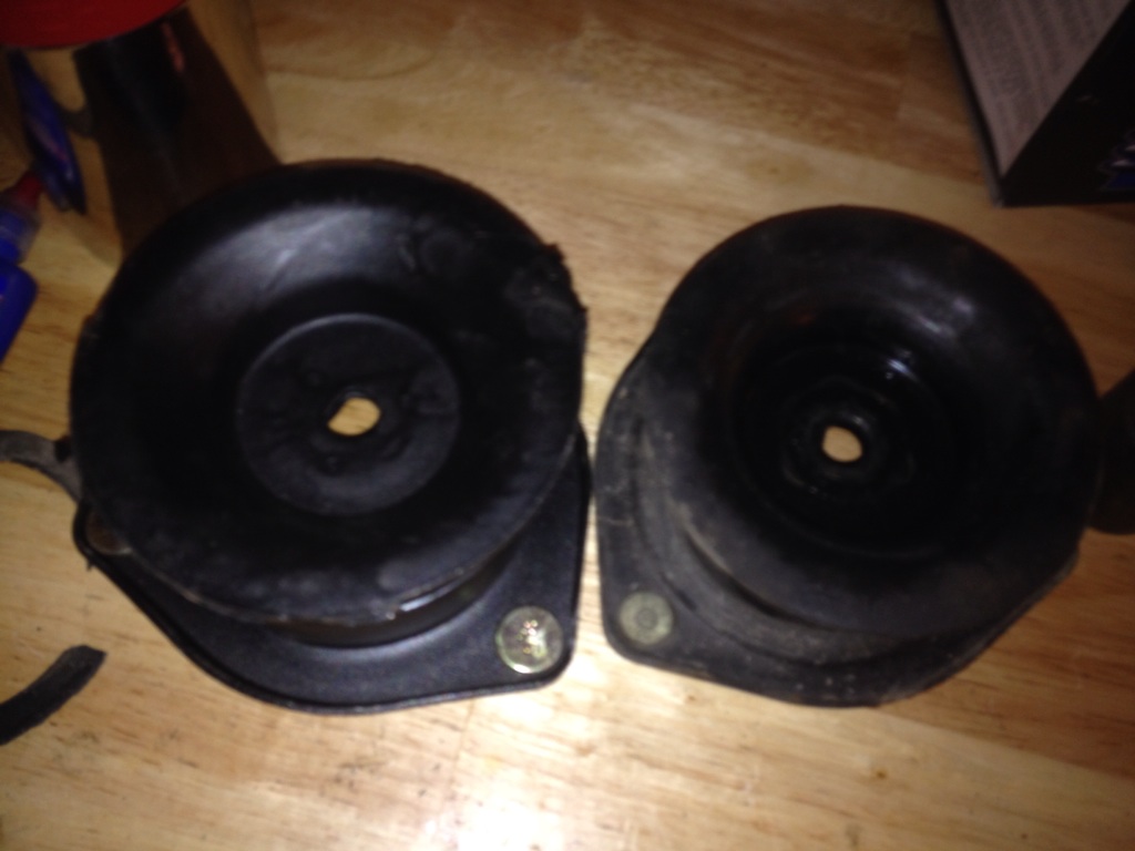

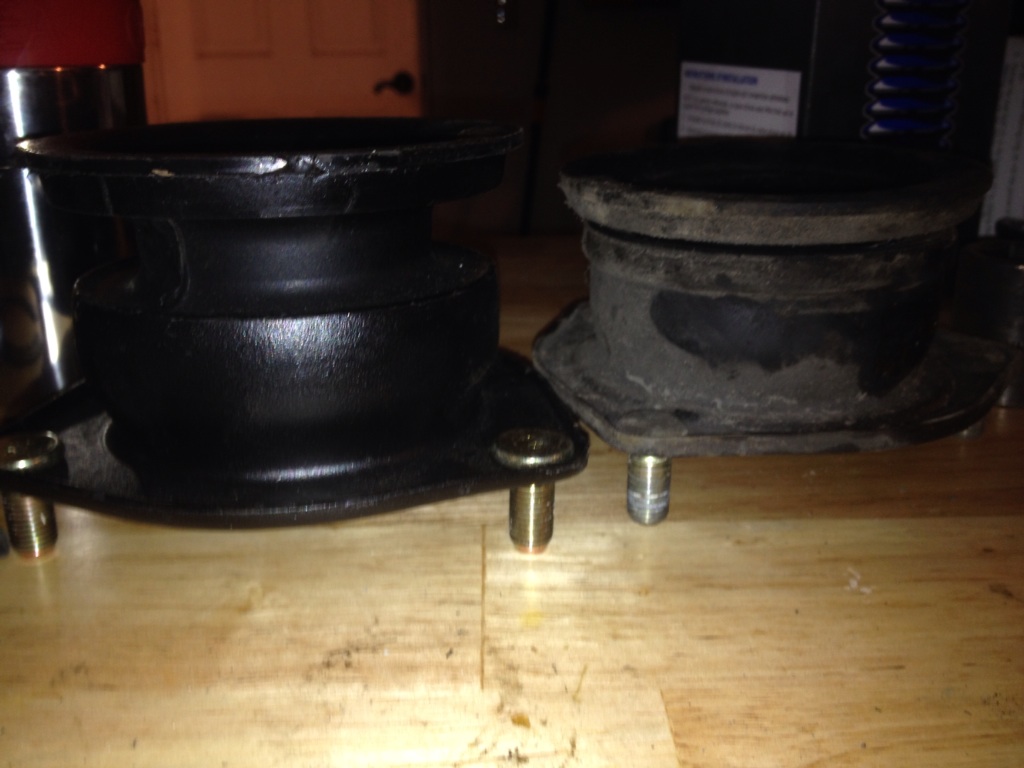

I've been dreading getting into the struts but the car rides really tough. Now I know why! All 4 struts were shot. Jacked her up and put her on 4 jack stands. Took less than an 2 hours to pull them all. Crazy. The rears were an hour. Fronts were 30 minutes and I had one replaced with all new mounts, boots and bering. I ordered all new for all 4 just because I don't like putting old on new. I gritted my teeth putting the old springs on but reading here told me I really didn't need to replace those. I am still waiting on 1 front strut and 2 mount kits for the rear coming on Tuesday I guess. Glad I ordered new mounts with the Monroe OE Spectrums because the mounts were taller.

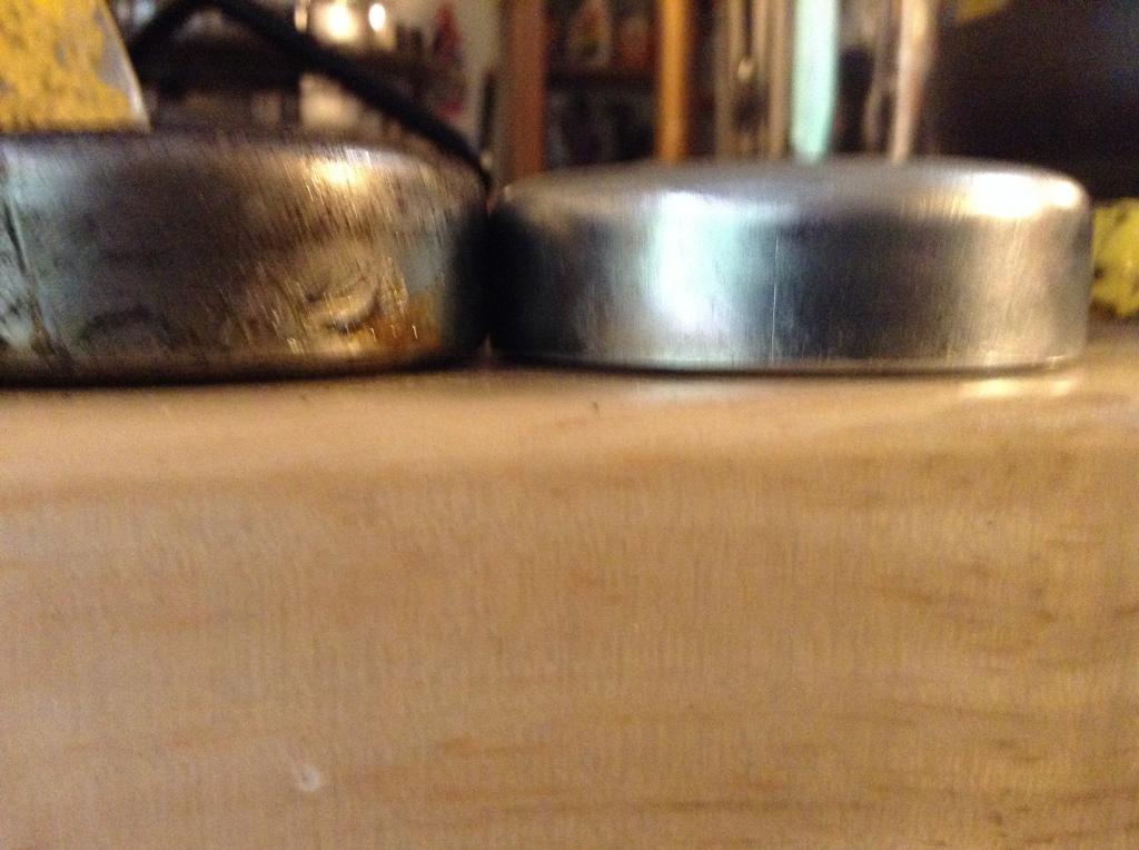

I believe this set would have performed differently had I just used the old parts. The berings weren't too bad but the new ones were a hair thinner to fit perfectly into the new mount! The old berings would have been nearly 1/16" taller.

All out now, wish my parts were here. This would have been less than a four hour job. Being Not a Mechanic....I like those!

For not being a mechanic you seem just as capable as any backyard/weekend mechanic. Replacing the strut mounts on the rear is necessary to fix the rear end sag these cars get plagued with. Good job
