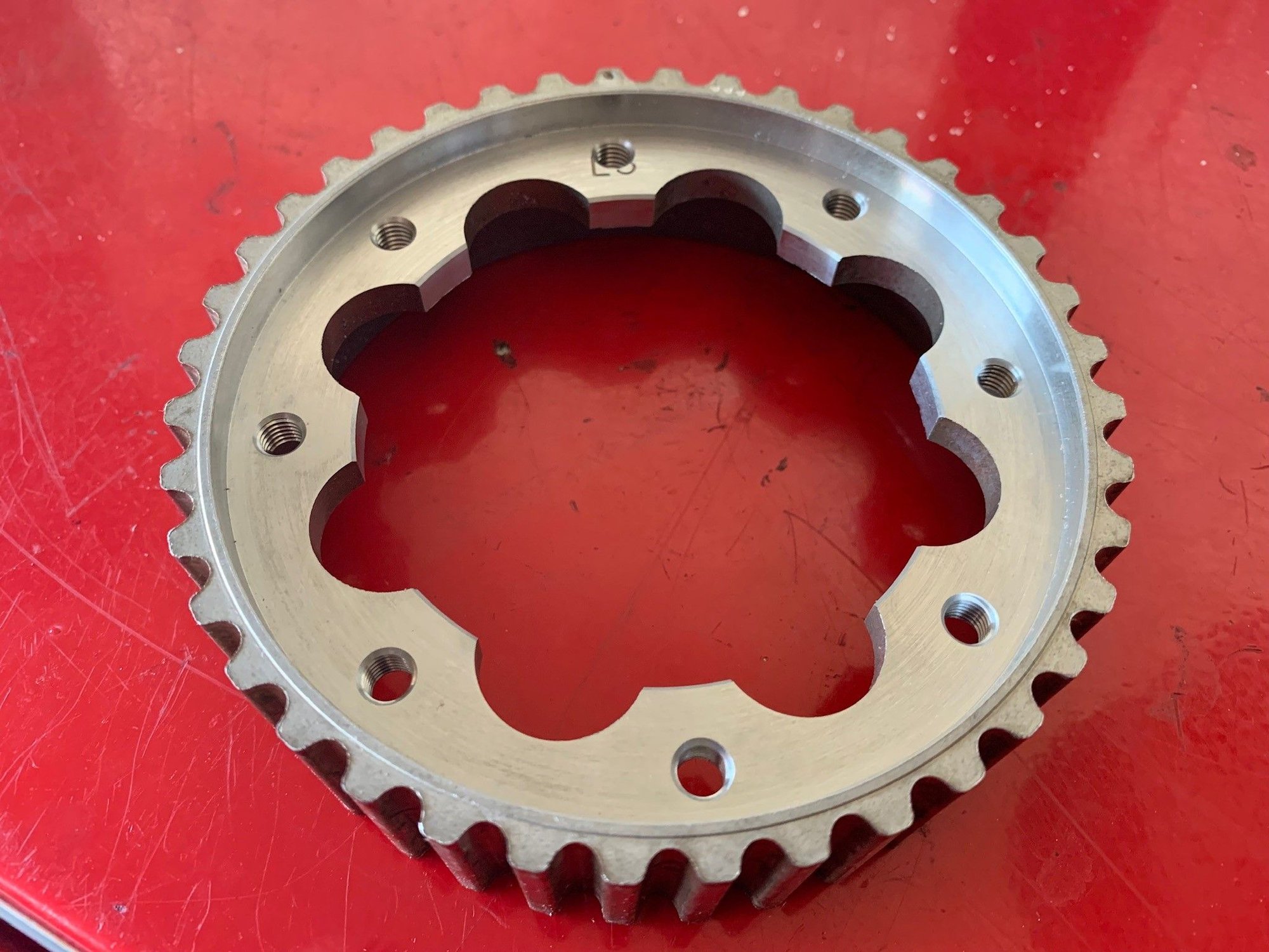

On a side note, VG guys I am now producing a line of adjustable cam gears (VG30 & VG33). First batch done and heading to anodizing & black oxide tomorrow. $295 per set shipped-

Lmfao, yes! I am also building 2 VG engines and I did not want to put in OEM cam gears. Russ adjustable cam gears are no longer available. I took matters into my own hands. I have 4 sets available (had 10 produced). 2 for me and sold another 4 (yes, no bs).
Keep in mind these fit VG engines from other models
VG30 Maxima, 300ZX, Pathfinder, Quest, Hardbody, etc
VG33 Pathfinder, QX4, etc
If you are running an aftermarket cam (Schneider, JWT, etc), you want an adjustable cam gear. I figured I could get what I want and help out the 3rd gen / VG SOHC community while I am at it.

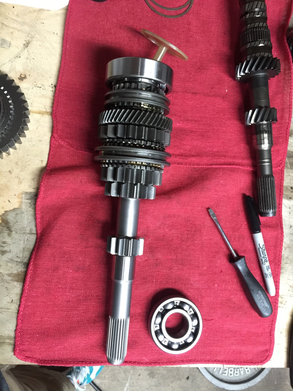

Saturday, I just randomly had the thought to put the transmission into each gear and spin the input shaft to make sure there's no binding etc. prior to installing it in the actual car. I had long ago made sure the tranny goes into every gear and spins in neutral but hadn't thought to spin the input shaft IN each gear.
Unfortunately it turned out that in gear, the darn thing would only spin in 2nd. Even with some vice grips on the input shaft it would NOT spin in 1st, 3rd, 4th, 5th, or reverse. It would rotate about 1/8 turn and just "clank" like it was hitting a wall.
I shot Haysam at PAR an e-mail Saturday night about it asking if he had any ideas and he wrote me back immediately that it sounded like the 1st/2nd slide collar deal must be touching the reverse idler gear - meaning that when you select 2nd gear, the slider moves away from the idler and thus there is no contact.
So I pulled the case back off and nope definitely no interference with the reverse idler gear. Although I was actually kind of relieved because if the slide collar deal actually touched the idler gear then I would just be SOL using this gearset, and also would have been annoyed at myself for not noticing it was interfering when assembling it.
I e-mailed him back late Saturday night that there was no interference and asked if he had anything else I should look for. He again nearly immediately wrote back that he had two ideas - no end play on the gear(s) or a "jammed" 2nd gear synchro. I knew I had enough end play so the 2nd gear synchro seemed like the culprit at that point.
Sunday I pulled the mainshaft out and noticed that I couldn't get 2nd gear to spin at all. Argh. So I disassembled the mainshaft again and sure enough the stupid three piece 2nd gear synchro deal was jammed together (that silver ring was stuck inside the outside synchro ring and wouldn't spin). I actually had to use a hammer and flat head to get them back apart.
Here's a picture of the offender. The synchro setup here has three parts. The outside brass ring, the middle silver ring, and then the innermost brass piece. Those three tabs on the silver ring actually sit into holes on 2nd gear itself - so this silver ring needs to be able to rotate independently of the brass part(s). This is what was preventing 2nd gear from spinning - the silver ring was "jammed" into the brass synchro so tight that 2nd gear wouldn't spin even with vice grips!
Attachment 15481
After I got them apart, I just put it right back together with some fresh gear oil for lube and them immediately re-assembled the mainshaft and put the whole transmission back together. All is fine and dandy now and input shaft is able to rotate in every gear. Pretty amazing that a "stuck" synchro can prevent the entire transmission from rotating.
I have to really commend Haysam for repeatedly answering me back immediately this weekend. It was my Saturday night but for him in Australia it was his Sunday. Had he not been so prompt getting back to me on a Sunday (for him) I probably wouldn't have suspected that 2nd gear synchro setup on my own - especially since I know it was assembled correctly.
So definite lesson learned. Make sure all your synchro cones/gears spin freely before putting the entire transmission back together.

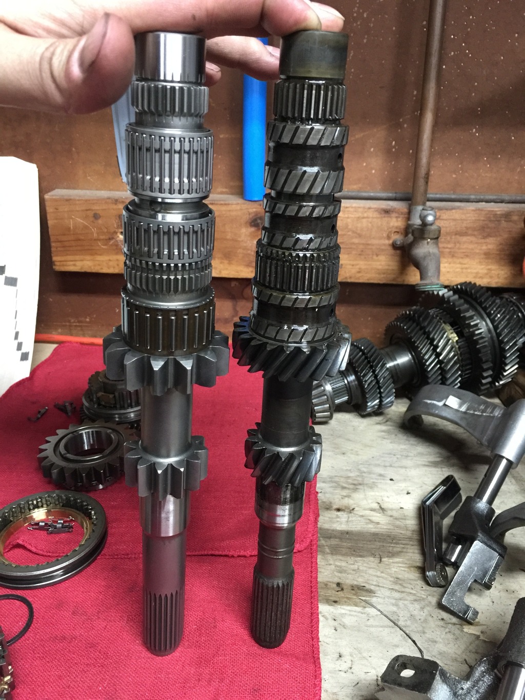

As you can see, in addition to the 1-4 gears, PAR also sends a complete new beefed up input shaft. PAR’s beefed up input shaft has needle rollers for 3rd, 4th, and 5th unlike stock.
PAR input shaft on the left, OEM on the right:
Attachment 15878

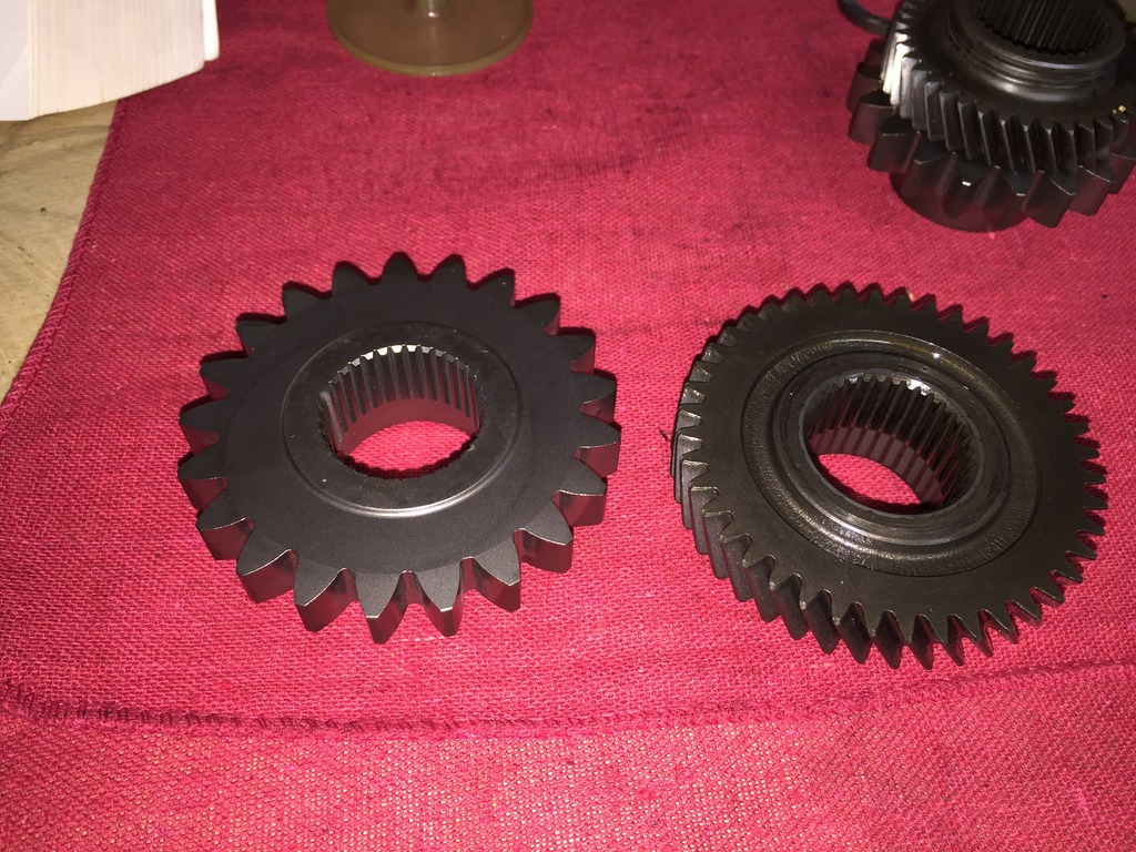

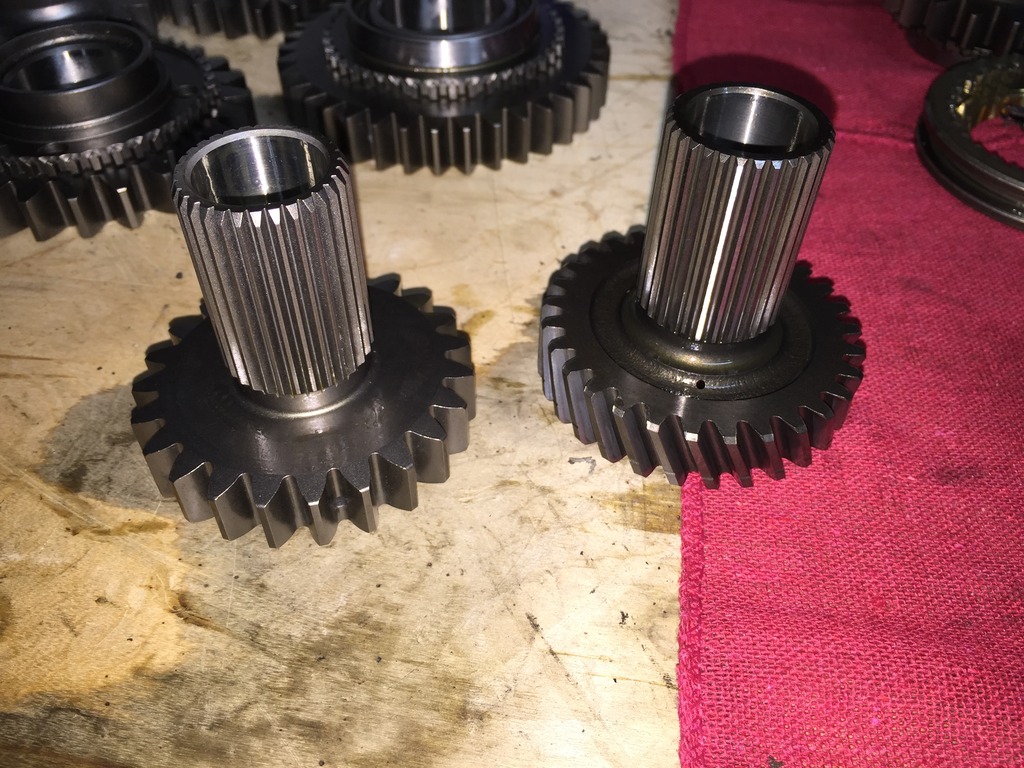

Onto the actual gears (obviously, input 1st and 2nd are already on the input shaft itself, and keeping factory 5th so no 5th gear comparison shots) –
PAR (left) vs OEM 4th input gear:
Attachment 15879
PAR (left) vs OEM 3rd input gear:
Attachment 15880
PAR (left) vs OEM 4th main gear:
Attachment 15881
PAR (left) vs OEM 3rd main gear:
Attachment 15882
PAR (left) vs OEM 2nd main gear:
Attachment 15883
PAR (left) vs OEM 1st main gear:
Attachment 15884
PAR (left) vs OEM reverse:
Attachment 15885

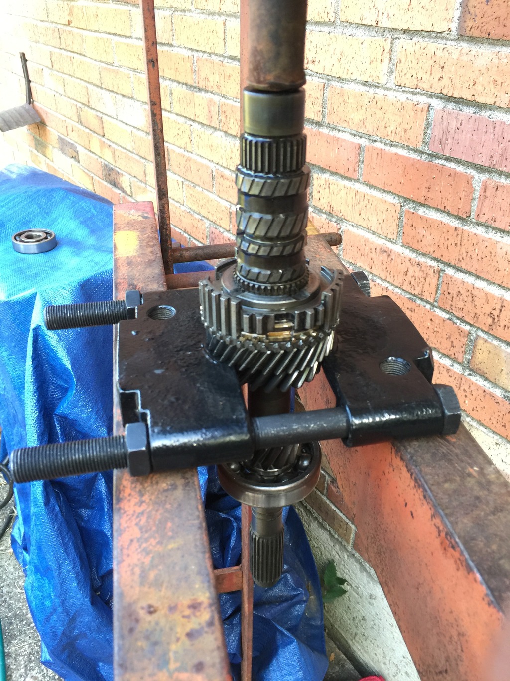

Surprisingly, I was able to do the entire job using just my press, the $30 “large” bearing splitter from Harbor Freight (which I already had and have used a bunch of times previously and am shocked it hasn't broken on me yet), and some combinations of a normal large 2 jaw puller and an old school ball joint/tie rod separator.
Here are some pics of the process, starting on the input shaft –
Removing old rear input shaft bearing:
Attachment 15887
Attachment 15888
5th gear and synchro hub deal removed (4th gear just slides off after this):
Attachment 15889
3rd gear removal:
Attachment 15890
Attachment 15891
No pics of front input shaft bearing removal but it pressed off easy. Everything removed:

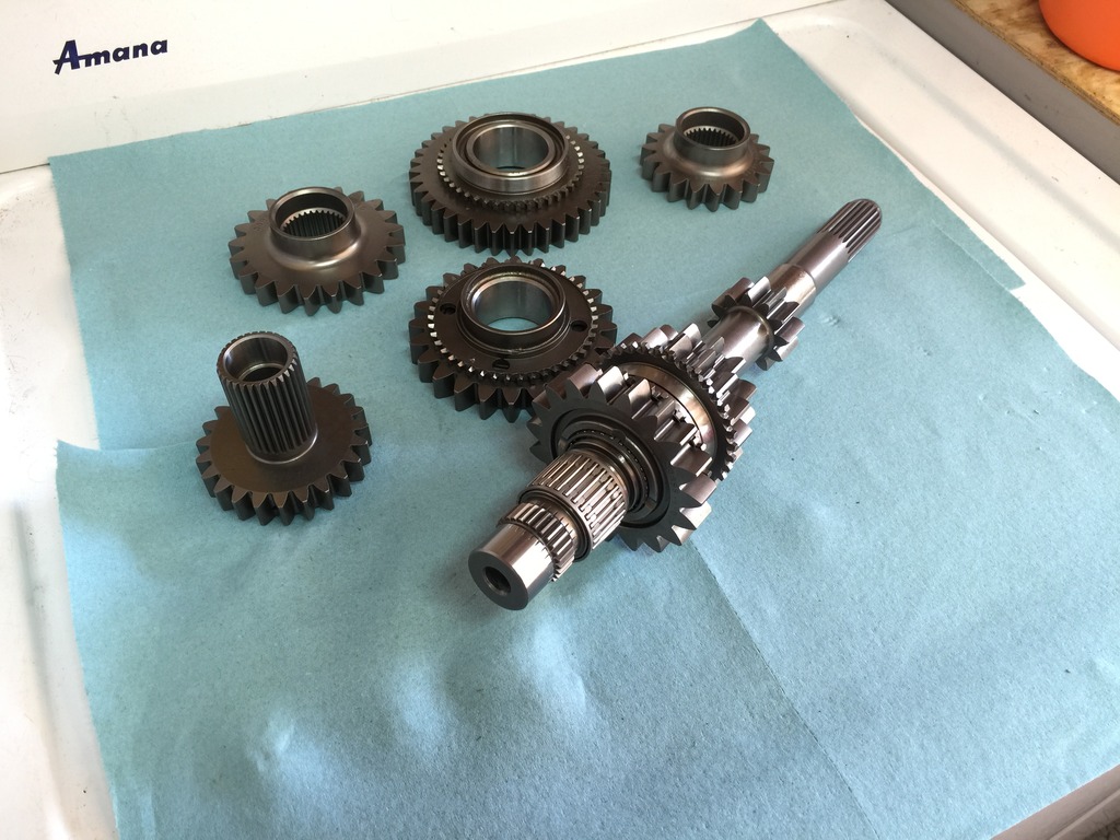

New PAR input shaft laid out with new synchros/bearings ready to go on (everything here went on real easy and didn’t even need the press except for the bearings):
Attachment 15893
Everything installed and rear input shaft bearing pressed on :
Attachment 15894

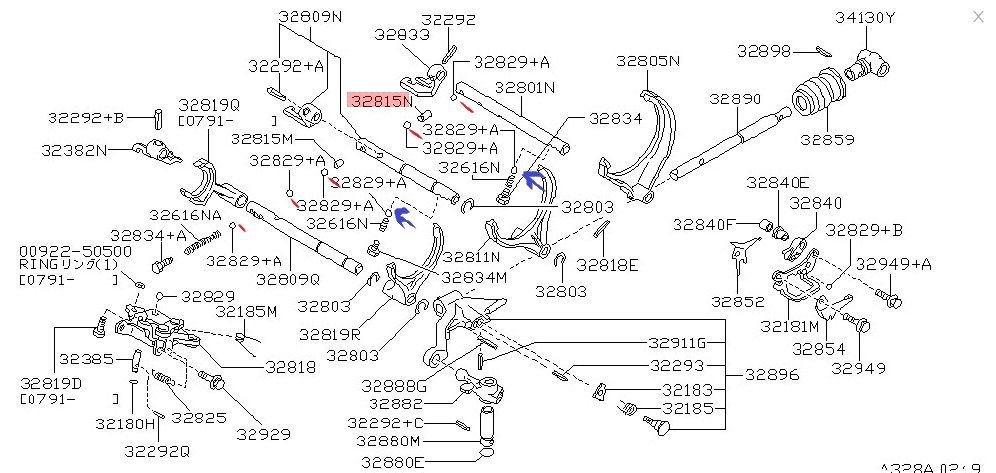

There are five of them on the selector rail (marked in red). Along with a couple plungers and spring. There are two with springs that go into the gearbox housing, which are marked in blue.

Haysam at PAR was actually strongly encouraging the straight cut, and told me that their "new technology" manufacturing practices on their straight cut gears are actually surprisingly quiet. He said my exhaust will almost surely be louder than the gears. In fact, he said many ricers actually are DISAPPOINTED in how (relatively) quiet they are and complain they aren't loud enough! It was unbeknownst to me until I started researching into this stuff online that a lot of ricers actually seek out and desire loud straight cut gear whine.
So I ended up figuring that having some 1-4 whine is better than having to potentially tear everything back down later on over a cracked case. l purposely kept factory 5th though so that once I'm in 5th/cruising/daily driving it should be totally quiet.
Hmmmm. Thanks for the heads up on the shims. That's surprising about the shims being on forever back order. You'd think they would be so often needed that Nissan would ensure there is always a good supply of them.
The transmission I'm using for this build is one I had rebuilt here locally about 10 years ago ($1,200) on my original black VE 5 speed. Stupidly, I managed to crack the bell-housing on it when I was re-installing it one day for some reason (I started tightening down one of the bolts not realizing the dowel wasn't totally lined up) and it cracked right across the bellhousing.
So it's been sitting on a shelf for years ever since. I actually bought a replacement bellhousing for it years ago from somebody here, nearly certain it was CapedCadaver but can't remember 100%. So I'm actually piecing this all together between my old transmission and Caped's parts he sent me. The old synchros and stuff I pulled out had noooo noticeable wear or anything on them though, so the shop must have at least replaced those on the rebuild I mention above. I did notice the main shaft bearings had NO shims whatsoever though. I wonder if it really truly didn't need them or if the place that rebuilt this trans back 10 years ago was just lazy. I'm betting on the latter.
I really bet 9 times out of 10, when people pay for a rebuild at a shop, the shop literally only replaces just the bad/broken part and slaps it back together.
I hope I don't run into a forever wait on shims. You got any links or part numbers handy for the McMaster shims? I have a buddy into domestic stuff and he assures me that universal shim "kits" are somewhat universally available but I haven't really stumbled across any.
They sent you an actual snap ring with that front input shaft bearing? They didn't send me a ring, but I did notice the groove in the bearing unlike the OEM one. I wasn't quite sure what to make of it and figured it's somewhat irrelevant. I just positioned the bearing with the stamped text of the race facing the same was as the old one
