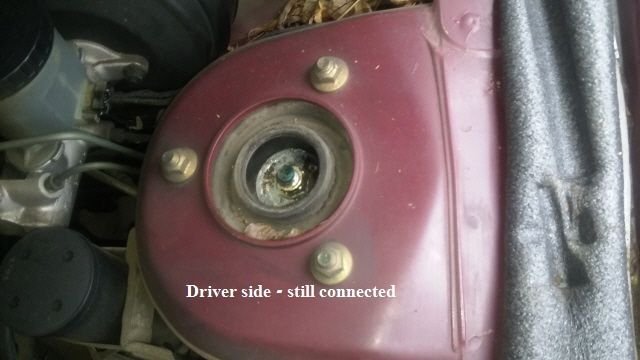

Here are the strut mount pics
the bad one - on passenger's side?
The bolt or nut does not appear damaged - it seems that whatever screwed into the nut - somehow over time unscrewed itself. i had been hearing a rattling sound but did not know exactly where it was coming from. after this incident I did not hear the rattling sound anymore....
the good one on driver's side
What do y'all suggest i do next????

new - get a new strut along with strut mounts. at this point might as well get two front ones. rockauto prices are pretty decent...if you have no idea what to do...then drive to your local repair shop and they can help you.
used - find a u pull it yard or whatever is around you...find an entire strut assembly along with the spring. again...if you don't know what you're doing then go to a repair shop.
price for struts will vary greatly (50 each to like 90 each). you will most likely need 2. find a good local repair shop and they will be able to help you out. you might need two strut mounts also your strut boots are trashed and maybe you need a bump stop. figure about another 30-40 for the boot/bump stop etc. labor should be about 1.5 to 2 hours.
if this is over your head seek professional help.

Wow this is so crazy. Your upper strut mount doesn't look damaged at all.
Are we even sure your strut broke? The strut "unscrewing" itself seems very unlikely to me.
I hate to keep asking you to take pictures - but can you take a picture of the top of the strut (if it even exists) between your spring? I'm curious if it actually broke, or if the threads stripped or what. Same angle as in that very first picture you took, but move that rubber bump stop and whatnot out of the way so we can try to see the actual strut rod (or what's left of it).
Had the front end/struts/anything been worked on anytime remotely recently? There is just no way for that nut to stay intact up there, and for the strut to come out (barring some MAJOR MAJOR trauma - like a catastrophic wreck) without damaging the strut mount itself unless that nut was either never screwed on in the first place or it had just barely been threaded on by one turn or something.
*edit* If it hasn't been said or if it isn't obvious, you'll need a new bump stop since yours appears to have been totally split

The nut doesn't seem to have a nylon insert so it's probably a regular nut.
What happens...the banging that he's hearing is the strut nut getting loose from the vibrations. So the threads of the strut is just sawing it's way around the D shaped hole in the strut mount. Eventually the nut just ran out of threads and the strut itself just lost its way from the strut mount. So the OP kept on driving and the bouncing just pushed the strut down. If it's a factory strut it won't come back up on its own.. (non gas charged) or if it's a blown/worn strut the shaft won't come back up.
So I stick by my prognosis...strut mount, bump stop, strut boot, new strut.
