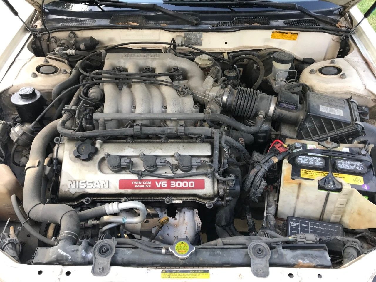

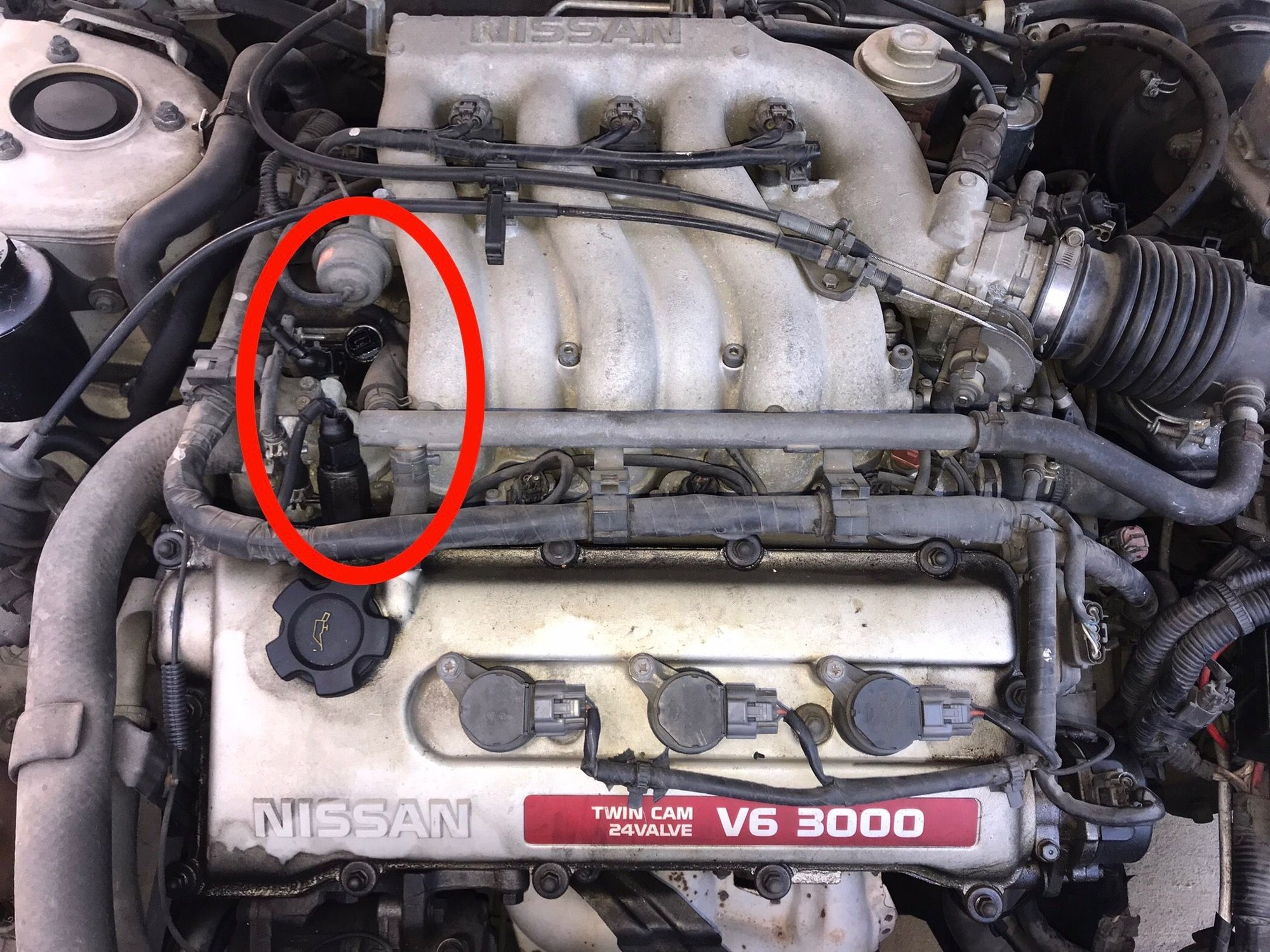

The engine has a misfire. I've replaced all ignition coils - to no avail. I think it's cylinder number 5 as nothing changes with the engine when disconnected. The car will stall randomly. The car will sometimes jerk like I popped the clutch. Sure seems like it's the IAC, but I replaced it to no avail. My suspicion is that it has a vacuum leak somewhere. I did replace all the vacuum hoses I could find, but I may have missed one or two.
It will idle well at 750 RPM and randomly drop like it's starving for air and either rev back up again or just die. In the picture of the engine, you can see that there's oil all along the bottom where it doesn't seem it should be.

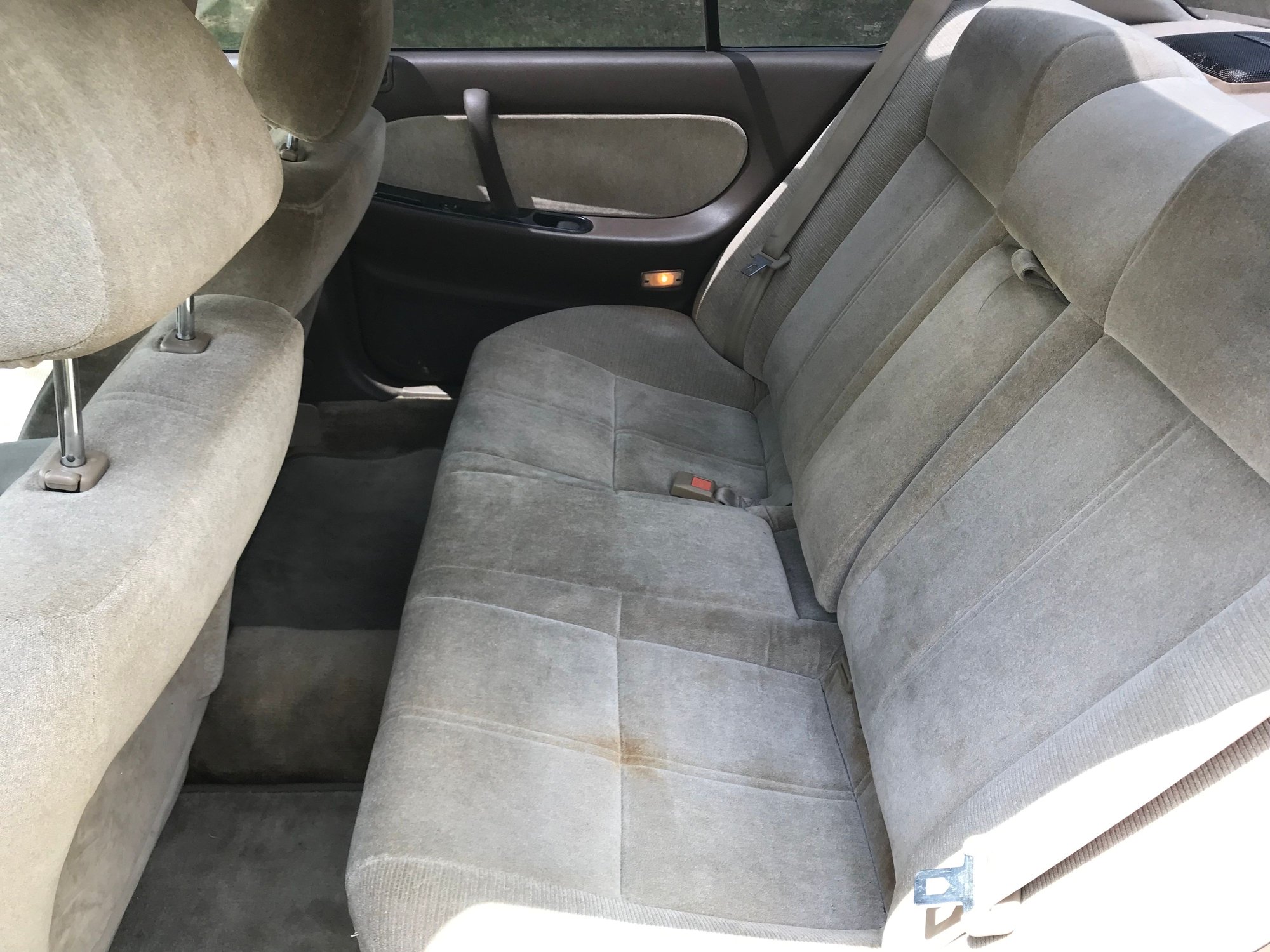

Various rust spots and stains on the fabric and headliner. Any recommendations for good cleaning products?

Have you skimmed through the FSM at all for any of your engine problems? I'm going to take a wild guess you have a bad fuel injector.

Some stains come out with a spray bottle of warm water and a wet dry vacuum. I have used Tuff Stuff foaming cleaner with great results on stubborn stains. Don't forget to see what you have on hand already, baking soda, white vinegar, etc.

I haven't checked any of the FSMs. Are they on this site somewhere? I know I have the VTC problem that seems to plague these engines. It's just noise when the engine is cold so it doesn't bother me all that much. I don't think it would be a bad idea to replace all the fuel injectors, but I think the rear three can be a pain to get to, am I right?

Replacing the rear anything is kind of a pain. It's also means time to plan for other maintenance such as valve cover gaskets, cleaning the EGR, and/or anything else that's in the area and would be easy to fix at the same time. BUT it's just a guess right now. You said you changed some vac hoses, double check those. If you still think it's a vac leak try a smoke machine to locate any leaks.Either way the FSM will help diagnosing the problem.

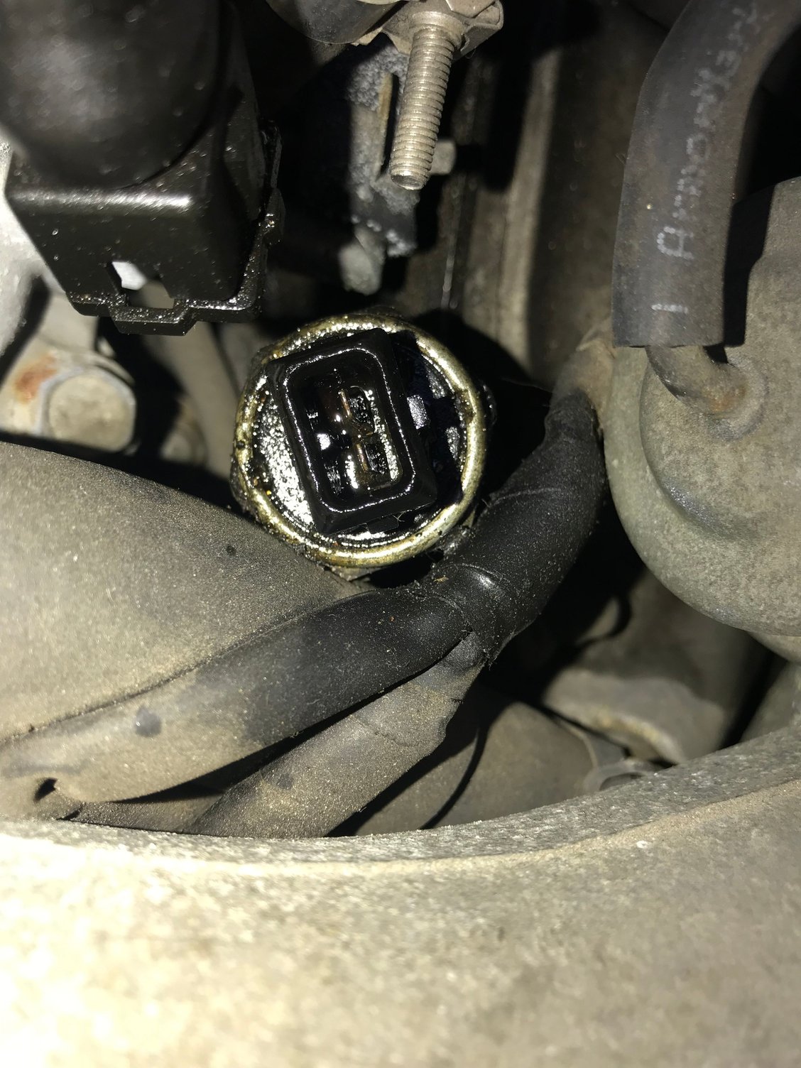

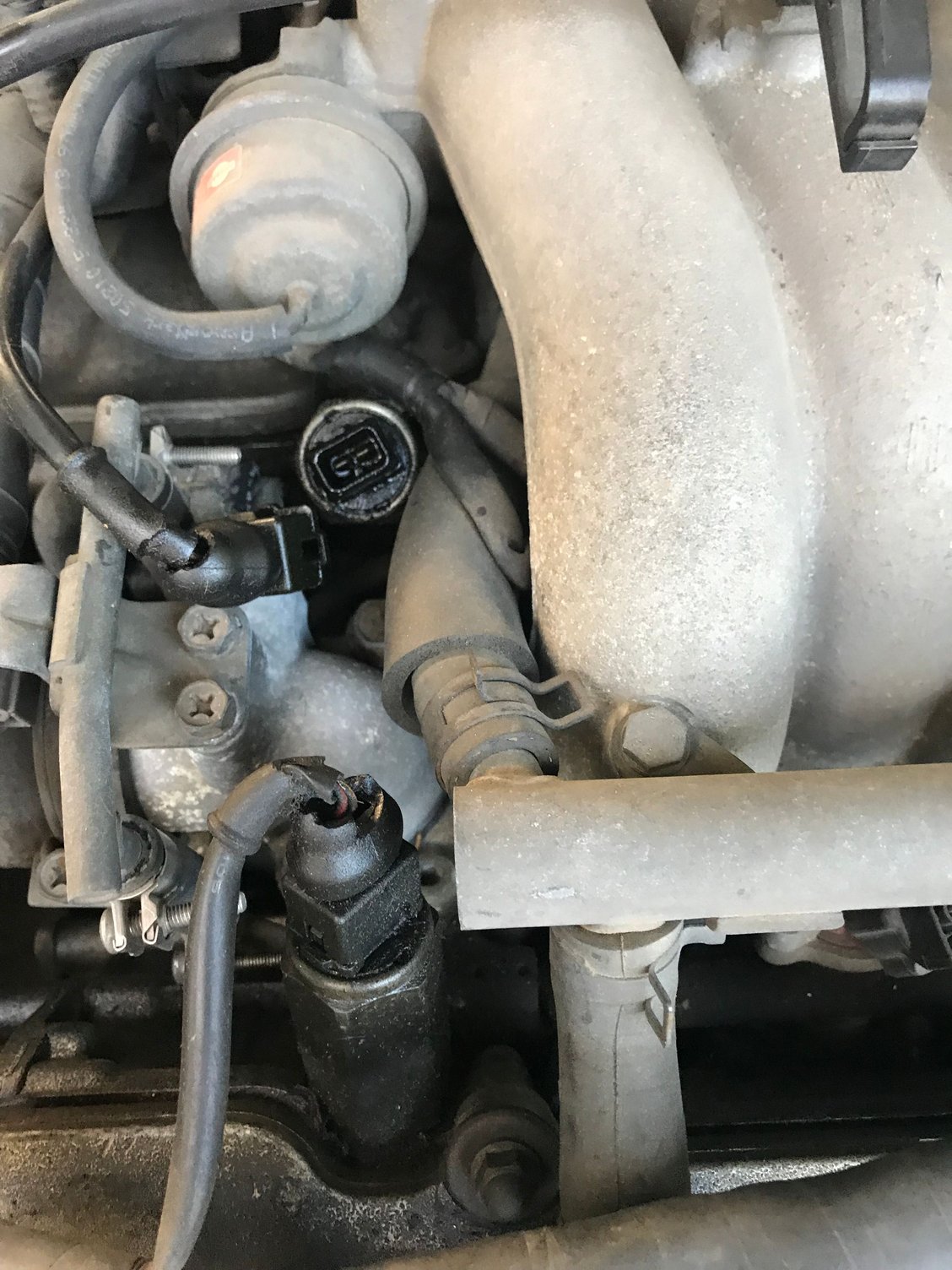

Can anyone tell me what these are? Doesn't seem right that there is so much moisture in there. I don't know if it's oil or gas. I assume this could be causing significant problems since moisture should not be on connectors.

Those are your VTC solenoid actuators yeah they shouldn’t have oil since the solenoid are threaded into the head with an o-ring around it.

OK, thanks! Where in the world can I get these? And how do you take them out?

I believe you need a 25 mm deep socket or combo wrench they are screw in as far o-ring I do not think they are available anymore

I thought they were pipe threads not orings?

You can order connector pigtails from online eBay or Rock Auto.
