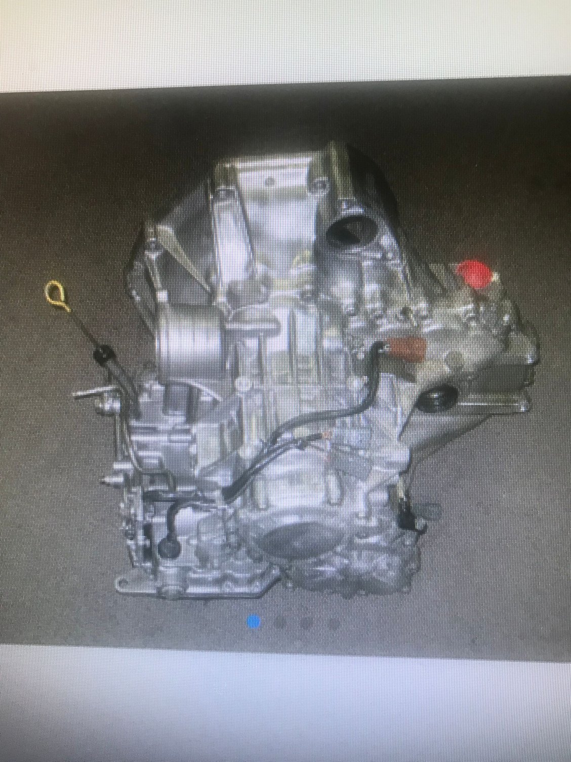

found a trans from a 93 se unlimited slip will this work for my 94se guys says there's a difference I believe there are 2 different trans ones a posi my code is my TRANS IS PE4F04V FN36 SAYS TRANS EJE ALSO ANY HELP WOULD BE APPRECIATED VIN IS JN1EJ01F4RT507312>>will this work??

If you found one with an unlimited slip diff, you need to crack it open and find out why.
92-94 5 speeds have an LSD, don't worry about urban myths from people on Facenet.

so a auto trans from 92 thru 94 SE cars will work for me then is this correct, thanks for your help again

his add read>> Used Automatic Transmission (Non-Locking Differential or Without Limited Slip Differential)
Works For:
1992 / 1993 / 1994 Nissan Maxima SE 3.0L DOHC (Dual Overhead Cam) Twin Cam Engine (Engine Code: VE30)

I thought you were talking about 5 speeds.. I'm not sure if any VE automatics came without limited slip, but I ran your VIN and it does, so it would work. I'd make sure your problem isn't an easy fix though before dumping money on a new transmission.
I considered it now found out it was just my cv joint that was damaged seems the shipper dragged the car up the ram in park
