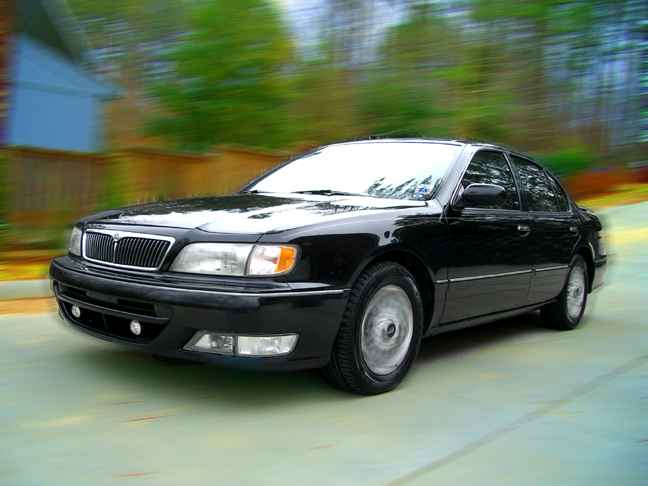

Here are links to the only pics that show anything worthwhile:
http://www.carylawoffice.com/images/door.jpg
http://www.carylawoffice.com/images/interior.jpg
And here's the car itself:
http://www.carylawoffice.com/images/NewI30t2.jpg
I can't figure out how to get the pictures themselves inserted in this post.

I edited the tags in your quote to show the pics.
That 5 dB drop is significant. Good work!
