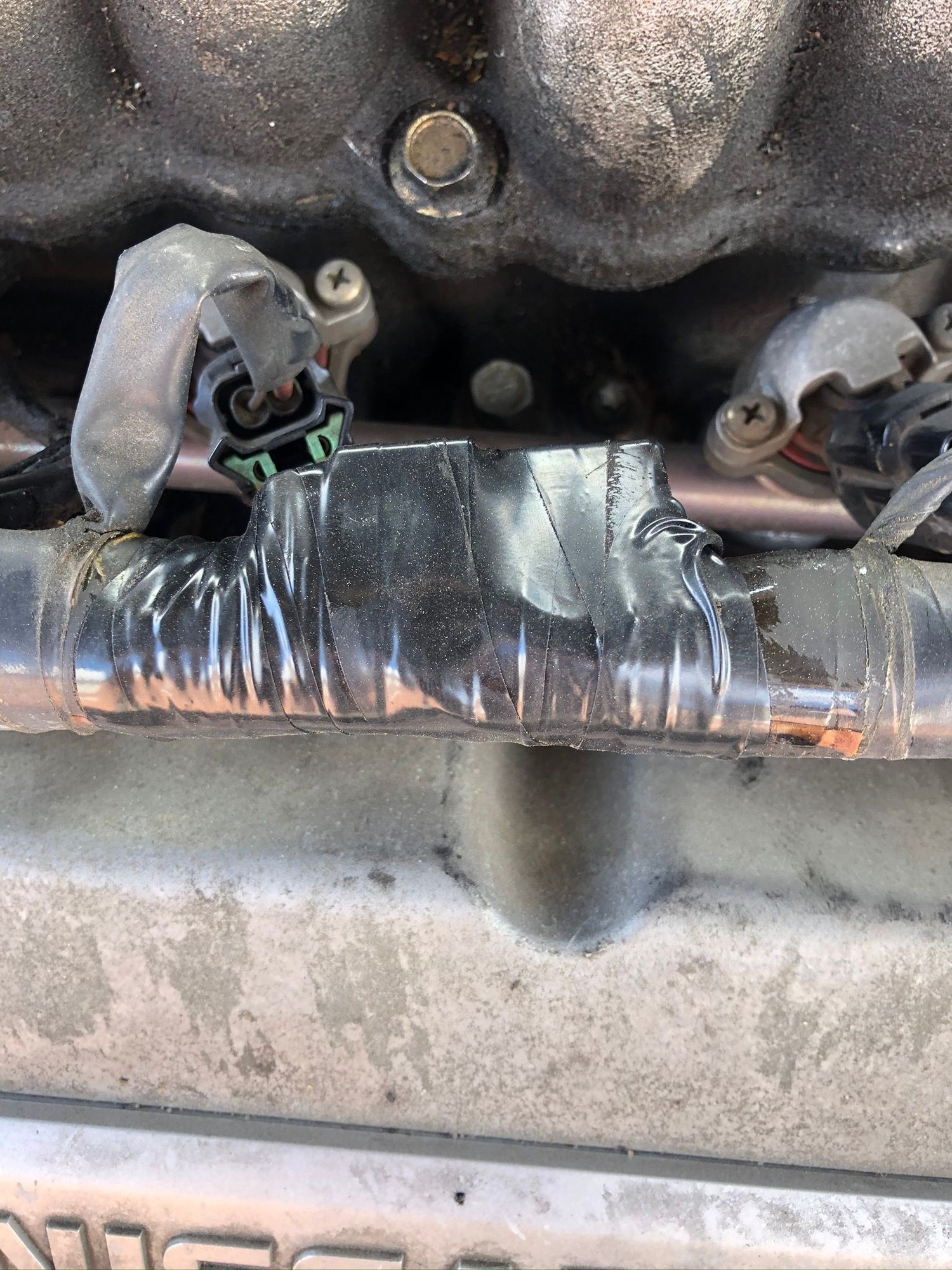

Bingo!
P1320 is a result to heating and cooling systems, ignition, wire harness and power. Check battery, change coils and spark plugs, check condition of all visible gaskets, hoses and wires.
99s are infamous for bad coils - and I am one to experience it - If there is a bad coil, change all six + plugs. After market isn’t oem but will get rid of rough idle.
p1320 will stay until electric And vacuum issues are resolved.
heres some pics of how I’m trying to solve this..
