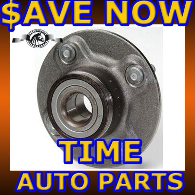

I bought this rear wheel hub assembly off ebay. It is for my 97 Infiniti I30.
I got it today and it is indeed a 4 bolt pattern. Shouldn't it be a 5 bolt pattern?
I didn't think it would be a problem that it said it was for Maxima's and not my I30. Every other place I checked said the Maxima rear hub's would fit an I30.
I am so confused

Nope. There are subtle sheet metal differences - for example, the taillights (hence trunklid and rear quarter panels) are shaped differently. There was a very good website detailing the year-on-year changes of every Maxima up to the 6th gen, but I can't find it right now.

So I went to the junkyard and took a Hub Bearing off a 95 Maxima. It fits my 97 I30 but doesn't have ABS on it. What would happen if I put a non-abs hub assembly on my I30? Advanced Auto had a bearing for the rear and I am now thinking about just finding a local machine shop to install it. Called around and places want $80 to $90 just to install a new bearing which seems crazy to me.
I was thinking about trying to order another one online. This one on Ebay was only $54 but I don't think this one will fit either. I think it is the wrong part also.
It doesn't look the one I just took of my 97. Which has the bolts pressed into. The part number 512203 is for a 2002-2004 I35.
Seriously WTF! How can these places not know which parts goes to which cars.
Edit: So the bearings I got from Advanced of course didn't fit. The guy on ebay swears that one will fit my car but I am skeptical. Can you guys take a look at the link and tell me if you think it will fit or not.
