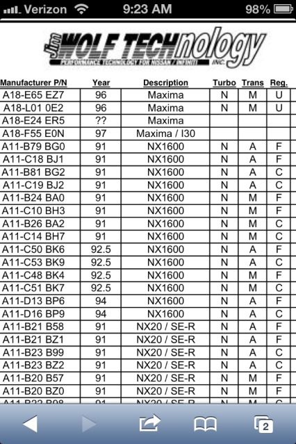

I know that the "F" and "C" on the JWT chart means fed or Cali spec, but what does "U" mean?
Old Apr 10, 2013 | 06:50 PM
  #8882
DennisMik's Avatar
Posts: 10,644
From: Plano, TX
I'm guessing it could stand for Canada as Nissan has 3 codes for North America. But the codes/letters on the chart are not the same ones that Nissan uses. The Nissan codes are:
U = USA, non-California
V = California
C = Canada

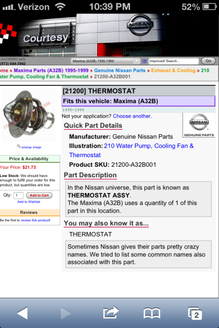

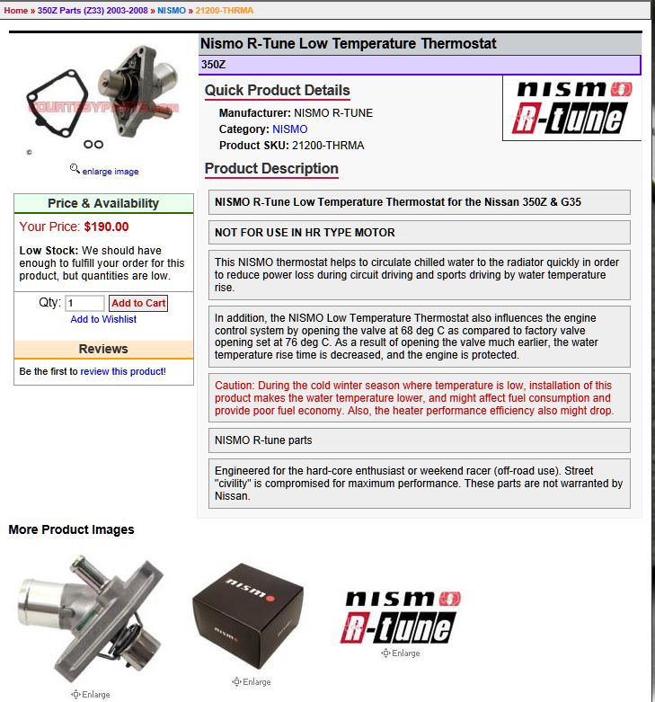

Upgraded my radiator recently and looking at the Z33 thermostats on courtesy, i noticed they have the exact same part number as our 4th gens.
That being said; how is the Z33 stat any better if it has the same part number as a 4th gen?
Same part then, right??
Where are you finding part numbers on Courtesy?
A32 part number is 21200-31U12, Z33 is 21200-4W01B, different parts.
Z33 thermostat opens at 169-174 deg F, A32 opens at 180 deg F

I was looking at the top number.
I see the product SKU is where it really matters.
Thanks!!!
Thanks!!!
Courtesy doesn't show any part numbers. They'll show the first 5 digits, which is the part code; ALL Nissan thermostats have the part code 21200, all oil filters are 15208, all intake manifolds 14001, etc. And I've just noticed, the first three of the part code are the FAST section they're listed under.
The actual part numbers come from a lookup of the part code and the chassis code, with engine/trim/trans/etc options set as needed. Most everyone gets confused by Courtesy's site.
Thanks!!!
WRONG the Low temp one is dis one right here! and you have to swap it into the old housing.i have one somewhere when I find it just pay shipping and you can have it
Old May 24, 2013 | 09:33 AM
  #8919
Fakie J Farkerton's Avatar
iTrader: (51)
Joined: Apr 2012
Posts: 5,189
From: KCK
Sold!
