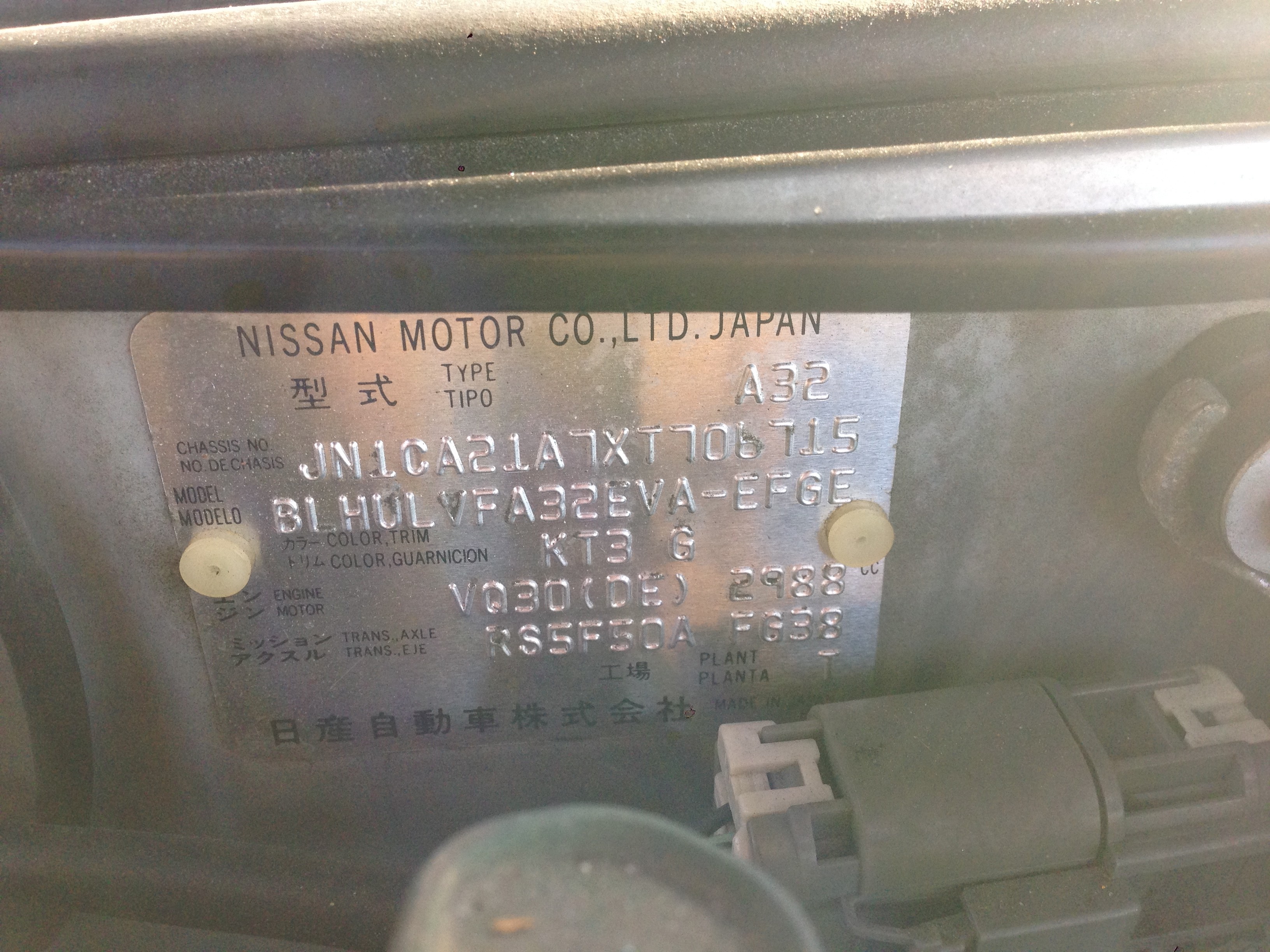

One thing you need to do for yourself and us is tell us what year your car is, along with other things that seem to be the problem (transmission, radio type, etc). While they look alike on the outside, they are different under the sheet metal. 95 & 96 are fairly similar, 97 & 98 are fairly similar and the 99 is in a class by itself. It has more in common with the 5th gen than it does with the 4th gen.

It is 1998 Maxima automatic transmission radio has been replaced .
I just got the car so i have little or no history
