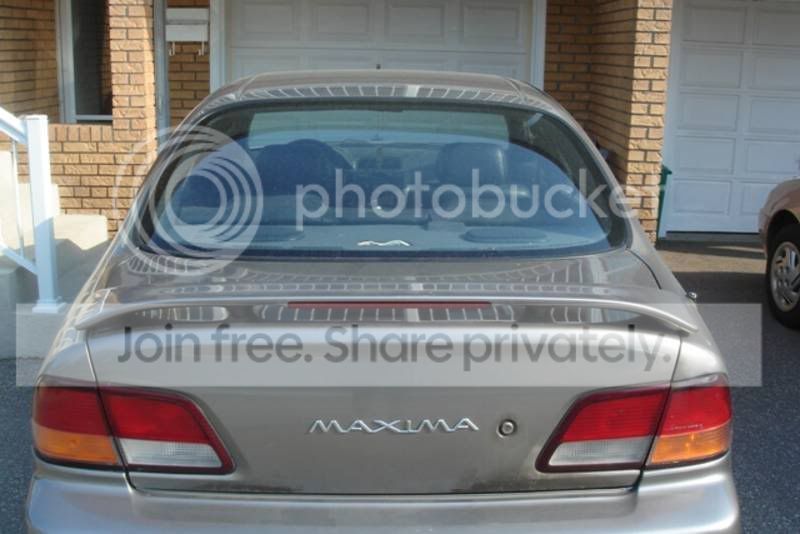

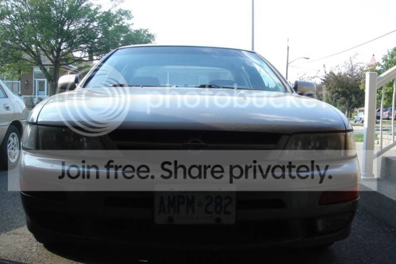

Old Feb 7, 2009 | 09:19 PM
  #97
FlyByNight's Avatar
Posts: 37
2 pics, I'll take more soon...
