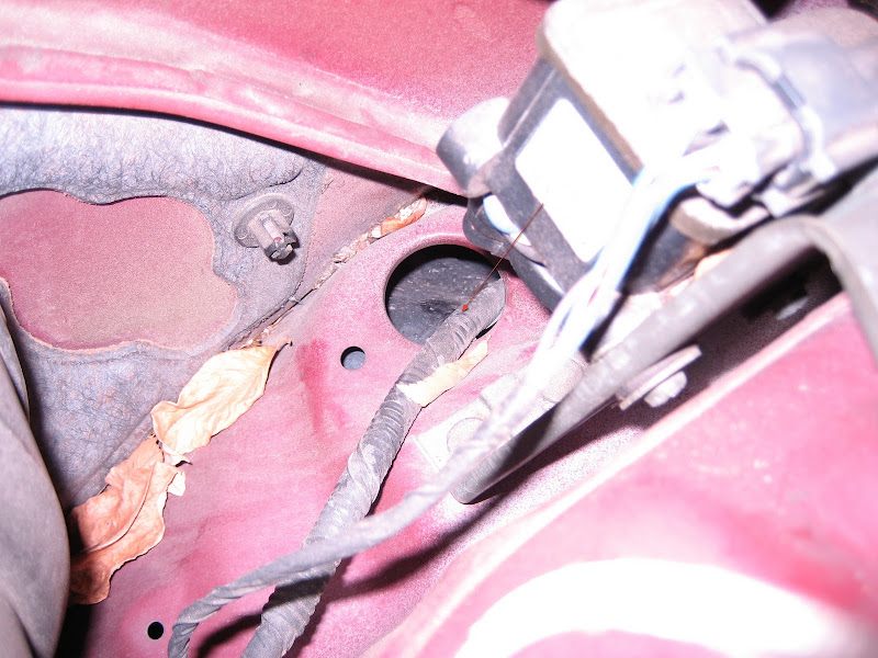

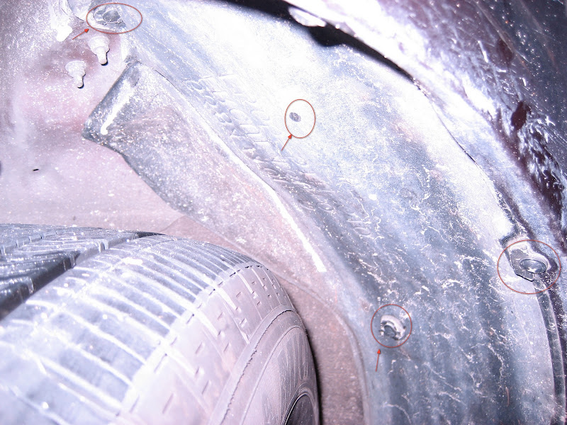

I had a small question regarding a wire that I'm trying to pull through the firewall. From what I've seen on this forum, most people seem to pull a wire through a opening through back right of the engine compartment as shown by the arrow on the first picture. Correct me if I'm wrong, but now to access the firewall area I need to remove the left tire splash guard correct? So I tried doing that, but I noticed that the splash guard has a few plastic bolts that is not philips or flat head, shown by the arrows in the second picture.
So, now my question is, I want to remove this splash guard so I can access the firewall, but do I just yank those plastic bolts out? I tried yanking, but I didn't want to pull too hard, cuz I didn't want to break anything. How did you guys take them out? And if there is a easier way to pull wire, please let me know. Thanks for your help.

I use a different hole on the fire wall thats covered with a rubber grommet. Take that grommet off and it goes right into the interior of the car, no removing the splash guard

Thos plastic "bolts" are two piece, pull the inner piece a 1/4" out of the outer piece and the fastener will slip right out of the hole.

Thanks, if you don't mind can you give me a snapshot or a description of the location you used? I'll appreciate that.

I used this hole when I was wiring up my amp and 00VI. It leads to above the gas pedal. All I had to do was remove the rubber grommet and feed the wire through. This is not my car, but here is a picture of it:

That hole's not on all 4th gens. It was on 5 of the 7 I've owned though.

Me and that hole have issues, it helps to feed some flexable metal through first to make a hook to pull the wire through

I put my amp cable though here but cannot find it on the inside of the car...HELP

FOUND IT...no drilling needed follow the pic above, when you on the inside of the car look by the gas pedal on top....just flash a flashlight and the red color will shine...THANKS GUYS
