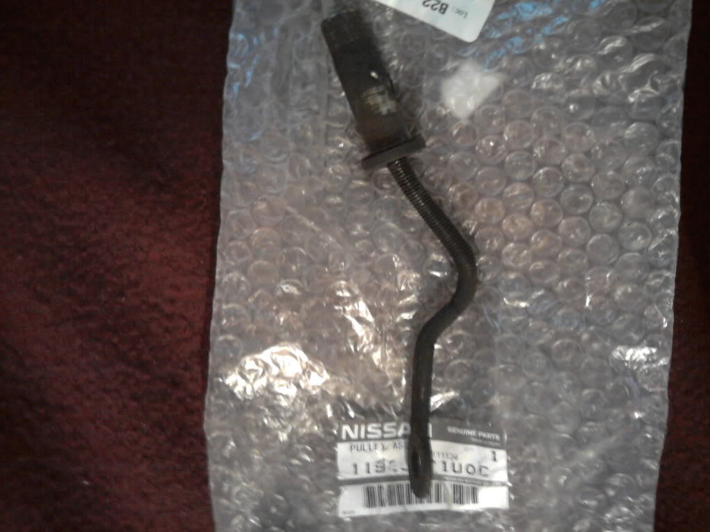

I have a similar issue so im bumping this thread. I went to change the belt today and I think I loosened the tensioner rod too much. Now it looks bent and wont even tighten back up and now my idler pulley sits uneven. Ive tried to loosen the pulley bolt and then tighten the rod and everything but it doesnt do anything. Will I need a whole new idler pulley/tensioner assembly or can I just order a new rod adjuster (or whatever its called)??

So I got a new idler pulley assembly for $86 at the dealership. I called around and found out they dont sell the whole tensioner pulley assembly anywhere but the dealership. So after putting the new assembly on (took about 30 minutes since i only needed the pulley and rod adjuster) I found out the bearing in my old pulley were shot.
To the OP double check to make sure the inside of the pulley isnt bad or the rod tensioner isnt bent like mine as this is wat was causing my grinding noise.
The bad rod tensioner
