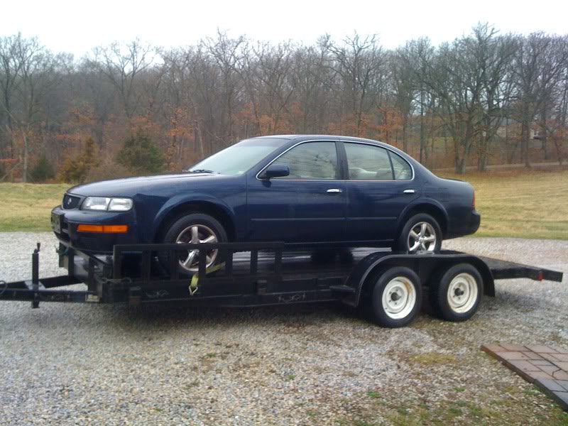

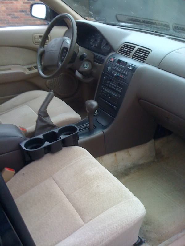

Welp, don't leave me at home with a truck and trailer unless you want something to happen.
More here: http://smg.photobucket.com/albums/v470/saddles/
Trans probably has something going on. Might still be computer issue, but I doub't it. I started it up and it took it a bit to idle on its own. Finally idled out at around 800rpm. Running terrible...I am not sure, probably coil packs. Ran it for a bit with no check engine light coming on. Drove it on the trailer, didnt have the power to drive up on the trailer aimed up hill.
Great looking car. Interior is very clean, paint is good, little clear on the rear bumper lifting. All in all very good car. All the power options work, non bose with CD. I guess its a GLE? No sunroof nor leather though....but the chrome door handles and windows. I forget how that breaks out. Walked away with it for $640 and 3 extra BBS wheels with it, haven't looked at them other than to see they were aluminum for scrap. Might be good for someone though.
I'll dig into it more when the rain lets up. Hopefully know whats going on one night this week. Couldn't let it sit all stranded behind that duplex...Its a Maxima , afterall!

thats a friggin clean interior compared to mine! I have your same interior with the exception of the SE white guages. My panels are torn up. I'm jealous of the way your floor looks. Seems like even with the work you have a good find! Good luck with breathing some new life into that max

@ Phromethius, yeah the looks of the car helped her come home with me. Saw potential even if there was work to be done. Body has a small dent I can pull out and clear is flaking off rear bumper and a spot on roof...not the end of the world, no rust. Little asian lady drove it, she explained how she never let anyone eat in it and how she had seat covers on it etc over and over as I checked the car over lol. It's in better shape inside than my old 4th and possibly even my 5th gen until I clean it properly....120k mi with the 5th gen has really gotten her dirty!
