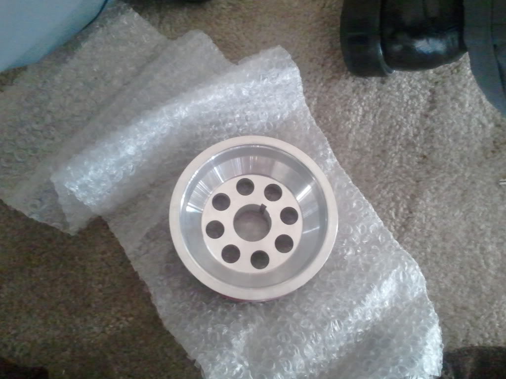

And $10 forba better brand... either or...
Got it today
Gonna start with same belts as unorthodox.. k060408 n k040292

Update us how reliabillity is and fitment is with those belts

Ive heard that these sometimes wear out where the seal rides on the aluminum, unorthodox pulleys have a steel ring slipped over (where the seal is) so that there is no wear and no leaks. Do they make a stock size one? Price isnt bad.

lol, well i can kinda give you that now as a buddy has one in his 5.5 going 6yrs strong no issues lol... this is my 2nd one, i had one for my 5.5 that didnt get installed thanks to the car being broke forever then sold

dont really know much about the ones for the 3.0 but ive never heard of this problem.. im sure the seals would be a good replacement when doing these, who knows the person whoever had that problem may have already have a bad seal... i also had a motostorm one before they discontinued and it worked fine for me

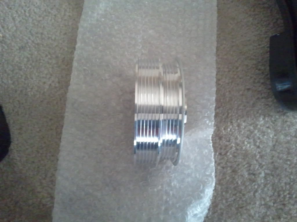

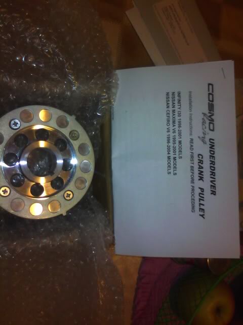

just picked it up, looks great

Go to URs site to get the part numbers for the belts. I have some no name pulley and 2 URs. They are the same size so I'd assume this brand is just another knock off.
As for the oil seal issue make sure the snout of your pulley has a steel insert. If its all aluminum the seal will eat the aluminum and develop a leak.
The only difference on the 3.5l version is the lack of the crank sensor timing ring.

Oh and lock tite the screws

Looks pretty much the same as my Ralco did, I used belts 048305... and 060431 Gates...
