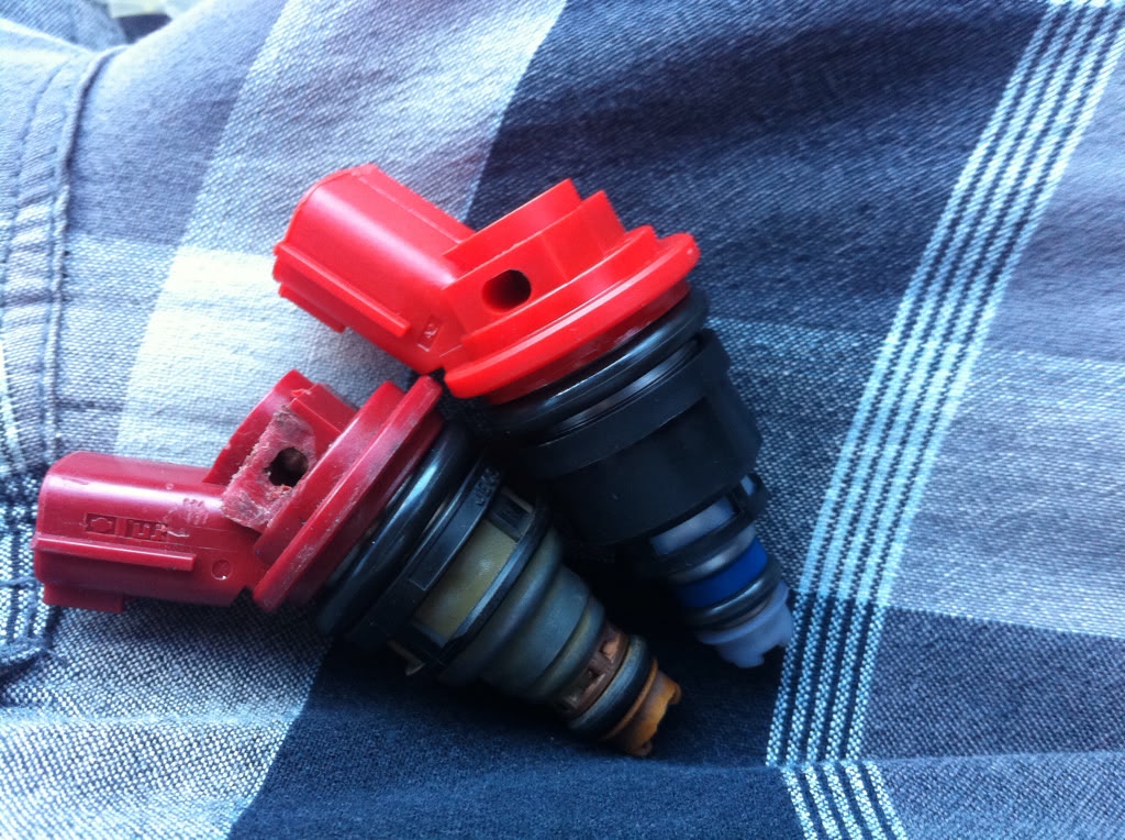

So I had an injector fail in my car and the shop was gonna get one from Nissan for $150. I told them hell no I'll get my own and replace it with a reman and return it later. I got one from autozone and when they went to put it in a big plastic shield with filter won't let it fit in the rail. Pep boys has the same one. What is wrong here?
Here is a picture. Te center section is the problem.

So I just had injectors replaced....and mine didn't have that...but it looks like a cap to me to protect the screening on the injector from the factory? Does that come off or is it formed to the injector? I would imagine you pop it off and install it as you would normally...

Nope. You can see the screen at the bottom of it. It is fitted on an doesn't come off. Headed to Nissan now to get an oem but it is gonna be an extra $30 plus a two hour drive in traffic.

Anyone? The one I got direct from Nissan looks almost identical to the autozone one. Only difference is the top of that black center piece is a bit narrower and the screens are a bit larger. Im going to the shop first thing in the morning to get my friend to show me exactly why it wouldn't fit.

The head of the injector is slightly bigger (meaning the top red part). It will fit with some force but will chip at the end of it as it goes down. Been there, done that and just got rid of it and bought OEM ones.

Nope, went there this morning and sure enough, the hole in the head where the injector slides into stops it before it gets all of the way in because of that large plastic bit in the center. No one, even at Nissan, has a clue why its all different but I just ordered an overnighted reman from rockauto. At this point I hvae about $300 in returns to make once this is finally done with.

This doesn't make much sense to me now. If you are trying to ask why its not going in flush with the rail, its because the cover has to push it down. You screw in little by little from side to side and it will go down flush.

The stock one slide right in with no problems. Screwing it down will start to crush that screened area.

Yeah those fit with no problems. The AZ one the top red part starts to crack when it goes down. That's what I was explaining earlier.

Ohhh.. Well new part comes in tomorrow and im going to take them all back up there and try them out. I just didn't want to damage anything and not be able to return it. The one I got from rockauto is a reman that looks like the stocker so I am hoping it slides right in. Then I can return all of the other bull**** I bought.
