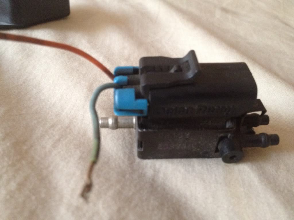

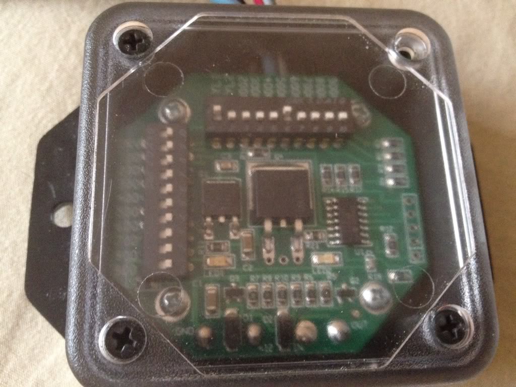

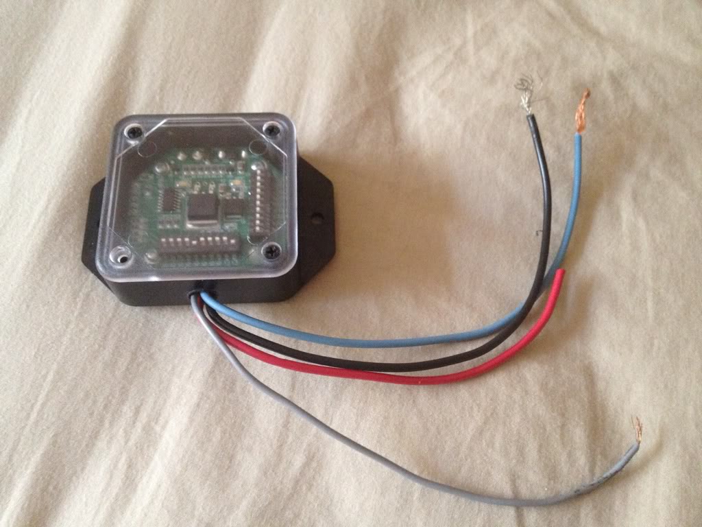

I'm installing a MEVI today. I have searched for summit switch installs for MEVI, but all of the how to's had a yellow & white wire comming from the summit rpm switch I do not have those wires. I have grey,red,black,&baby blue wires (only 4 wires) has anyone installed one of these to a MEVI? I'm guessing it would be the baby blue to tach, red to power,blck to ground,& grey to solenoid? I bought the switch used from another org'er but they are not available right now. Can someone advise me on how to install this to activate MEVI? Pic of solenoid is below as well. Thanks in advance

i would assume that your guess is correct, but that is a different summit switch than we all used to get when doing mevis.

I found this. http://static.summitracing.com/globa...m-830449-1.pdf
I give that a try. Grey to rpm, blue to solenoid is what I'm seeing

pretty straight forward.......

You got it.... gladi got a harland switch on mine... however my mevi is for sale... lol engine swap this winter...
