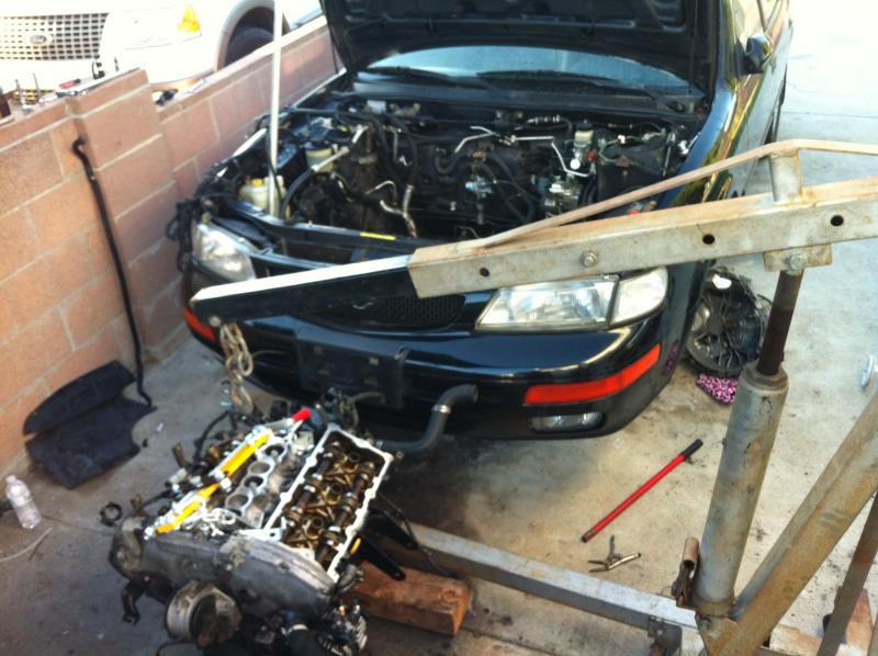

Sounds like my laundry list...I just picked my Maxima up a couple months ago, started with a strut, which turned into 4 and new springs, then a valve leak...clutch...rear seal and a lot of other things that I keep saying, "since I'm already doing this, might as well..."
Edit: It has 198K on her.
Here is my progress so far! Hahahaha
Attachment 2760
