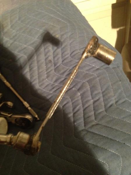

Has anyone ever had a issue getting the knock sensor bolt tightened down?i dont know if i missed the threads or whats going on but it just wont get tight.i'm unable to see if i got the bolt in the wrong hole if there is another hole close to where it came out of.
Fixed This^
Ok here we go so the sensor is in and connected the code is still there now even if i bypass with the resistor the code is showing up and
1. i am sticking the resistor in the correct side(car side)
2. i went from having 2 codes on the scanner for the KS to 1 code

Make this then do it
