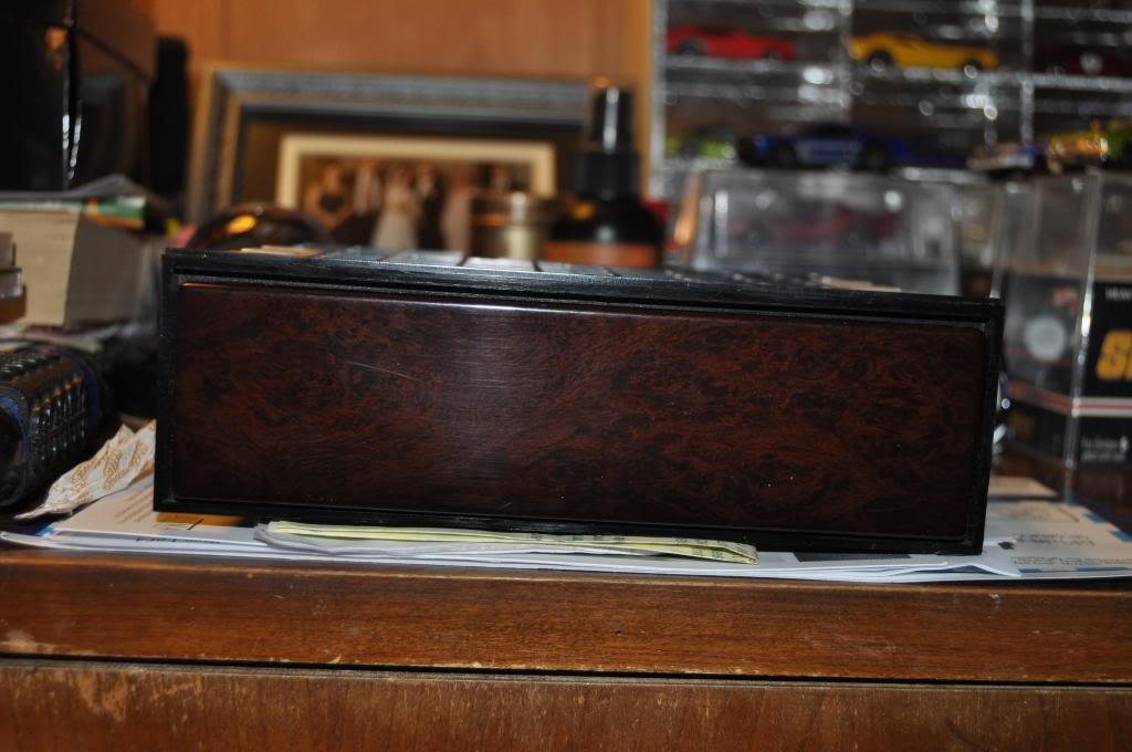

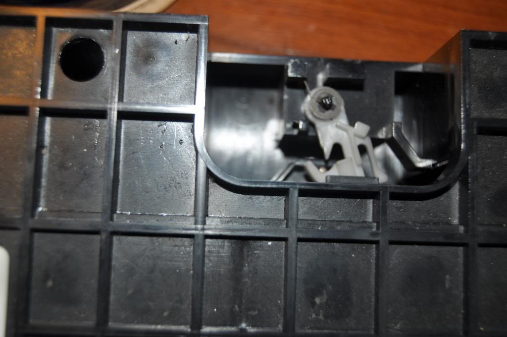

now you tell me!! i just went to the junkyard and found one that matches my car exactly out of a 97. can you lube the sliders to make them work better? also, is there a quick write up to pull this out? i noticed in the j/y car that it was attached to the upper piece with the stereo. i've seen my h/u out when it was being installed, looks like a bit of a headache. also, what broke is the little white plastic locking piece in the back, slides out and in fine.

here's the back of it and the clip i was talking about.

Pretty easy removal. Pry up the surround around the shifter. Remove screw from ashtray. Pull out heater vents (with buttons). Remove 4 screws holding in radio bracket and dash housing.
That white plastic clip to close drawer is finnicky, I'd swap it out.

you can't swap out the plastic clip, they don't just make it seperatley. i need pics of this, i took it apart b4 and the bottom comes out easy, the top is a bit more of a pita.
