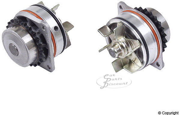

Yes, there are two O-rings, inner O-ring seals coolant and outer seals oil, see the following picture, if the inner O-ring fails, coolant will leak out through the seeping hole:

Well, you need to drain coolant and oil anyway before you start taking it off, so an oil change at the same time. Mine is leaking at the same spot too so I need to do it in near future.

It's a fun task. You will probably want to replace the timing chain tensioner while your doing it. Oh big note. Water pump bolt torque in manual is in INCH POUNDS.
You will have to change oil afterwords since coolant will drain out of water pump hole into timing chain cover.
Other note, get an extendable magnet, will help to remove water pump bolts, without droping in timing chain cover.
You don't have to remove motor mount. a swivl is nice.
The link is in 4th gen disscussion, 4th gen how to's.
http://vqpower.com/v3/content/water-pump-replacement
