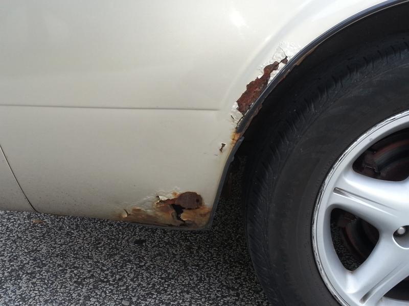

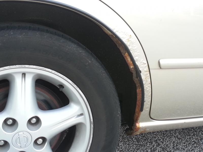

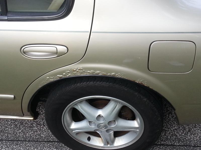

picked up a 99 maxima from a dealer about two months ago, has 91k original miles, bought with p1320 code, figured id mention, dealer replaced all 6 ignition coils w/ new hitachi oem coils(upon request after extensive research)they def would have put the aftermarket bs in, codes gone & runs like a champ. body is in great shape other than the ridic cancer on the back fenders(friend has a 1993 f150 w/less cancer lol) shes old but would like to clean her up so any suggestions on how i should go about this would be great, also recommended spark plugs, oil & rotors, plan to buy all 4 rotors pads & possibly calipers..looking for a all black grill w/out the nissan logo, ebay didnt have it..any other suggestions on body, looks or performance would be greatly appreciated..this is my first maxima

The only way to get rid of rust is to cut it out and put new metal in its place. By looking at the pictures, that rust is extensive. The band aid is to grind it down, put a rust neutralizer on and slap it full of plastic. It will look nice for a few years, then your back to square one again or worse as it spreads to the inner body sections.

yea its rotted out..clearly sat for awhile..what percent tint do u have

low mileage and all, too much rust for me. i passed up an 02 se with 88,000 because of the rust in the rear quarters. bondo that $hit and just paint it.

As for the new max id say a full tune up couldnt hurt, who knows if it ever got one in its life. The rust should at least be hit with a rust preventer to slow it down, but eventually its going to eat the car unless you cut it out, weld a piece of metal in, and repaint it. Quite a pain for us in the rust belt as the rear fenders are prone to rust and cant be replaced without major bodywork.

i did my right rear quarter, wheel well, and part of my rear bumper support here in pa for 8 fifty!! fresh paint and all...
